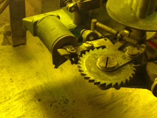

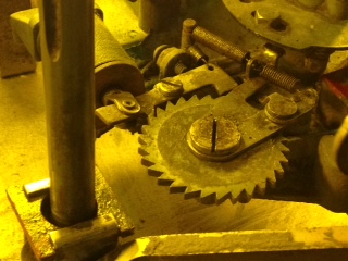

I recently purchased this 1941 Rockola (unsure of model- was told Deluxe). It was setup to play on quarters. It worked for awhile and then all of a sudden it just stopped. when it quit playing it started to have a loud hum. I narrowed that down to what appears to be some sort of actuator (in photo1 which pushes or pulls lever from gear wheel). When a coin is dropped in I get 3 or 4 clicks from the coin mechanism and nothing happens.
I can manually play one record at a time by disengaging the lever from the gear that is pictured. Once the record is done and the cycle finishes the lever locks back into the gear.
So I'm not sure if I have a coin mechanism issue or if that actuator is bad, or something else entirely?

by MattTech » Thu Nov 27, 2014 4:01 am
Clean.
Oil.
Mechanism problems are easily rectified through the troubleshooting chart in the service manual.

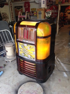

Being entirely new to jukebox ownership but not shy to get elbow deep in one. Are there good sources for parts. And can someone help with verifying identity of this jukebox. Is it a 1941 Rockola?
Re: 1941 Rockola Deluxe
by Ron Rich » Thu Nov 27, 2014 6:22 pm
Judging by the photo in the Always Jukin' reference book, it's a1940 "Master" model.
See "informational stickies" posted above for all parts/manual, suppliers. Ron Rich

by ds100h » Thu Nov 27, 2014 6:33 pm
Ron
The Always Juking' book shows it has 20 selections and plays 78 RPMs. Also shows value range between $350.00 and $3,200.00 or whatever the market will support!

by vintagecar » Thu Nov 27, 2014 7:16 pm
Much thanks guys!
I cleaned and lubricated around that gear and lever and that did the trick. Still has some quirks to work out such as a quarter will play anywhere between 1 and 7 records. Some of the push buttons work and others will not release after the record is played so it just loops that particular record. Does any of it really matter? Not that much...gives me something to tinker with.
by ami-man » Fri Nov 28, 2014 1:24 pm
Hello Matt,
Welcome to the forum, yes your jukebox is definitely the 1940 Rock Ola Master.
I Guess you will have issues trying to get parts for it, but the mechanics involved will not be too difficult to have some parts made and you can have any coils or solenoids rewound.
