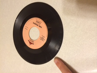

It shows the scratched flip side of a 45 from the D7 slot on the Seeburg. I placed it flush on a clean table and observed the record closely and I could see slight warping but not enough to cause it to rub against the record rack. I placed it back into the D7 slot and observed closely as it was playing and I did not see any problems with clearance. How else could this scratching occur?
I also noticed that some records when playing are centered better than others. Do I need to reposition the record rack? If so, how to I know when it is truly centered? It looks like some slots are a bit wider than others, is that a bent rack or are there ways to adjust them all individually?

As for rack problems--before you do anything here, check the clutch --have you PROPERLY oiled it with 20 wt. ND oil-- if so, check the adjustments--pay particular attention to #3, adjustment, being sure that the follower is down as far as it can go--
If that's all correct, see the manual for rack adjustment procedure. Ron Rich
