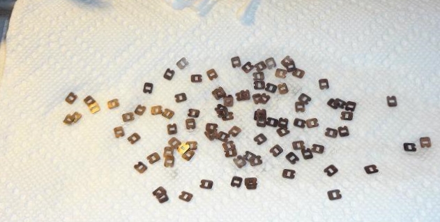

Another question. In the Facebook thing it is stated. OK, Listen up! There is a rough side and smooth side to each tab along with a indent. THE SMOOTH SIDE DOWN and the indent towards the outside! Point them towards the yellow coils. All this matters or it wont work.
My tabs are metal and i do not feel or see a rough or smooth side. What is that all about?
Stan Ski
Re: Seeburg M100C
by Ron Rich » Mon Oct 05, 2015 12:37 am
Stan,
Are you talking about the washers that make the ground contact--If so, put your glasses on, or see an eye Doc-- :lol:
(be careful of what you read on the web !!)

I am referring to what they call tabs. They go on the bottom of the forks. Here is his picture. Like i said mine are not copper or brass.
Re: Seeburg M100C
by Ron Rich » Mon Oct 05, 2015 1:18 am
Yep--them there is them--called "contact washer" in my book ?? ( Like I said--be careful of what's on the web !!)

So what the hell is this guy talking about? BTW I have no idea who made this Facebook stuff but it should only be used as a rough guide and they should have stated that.
