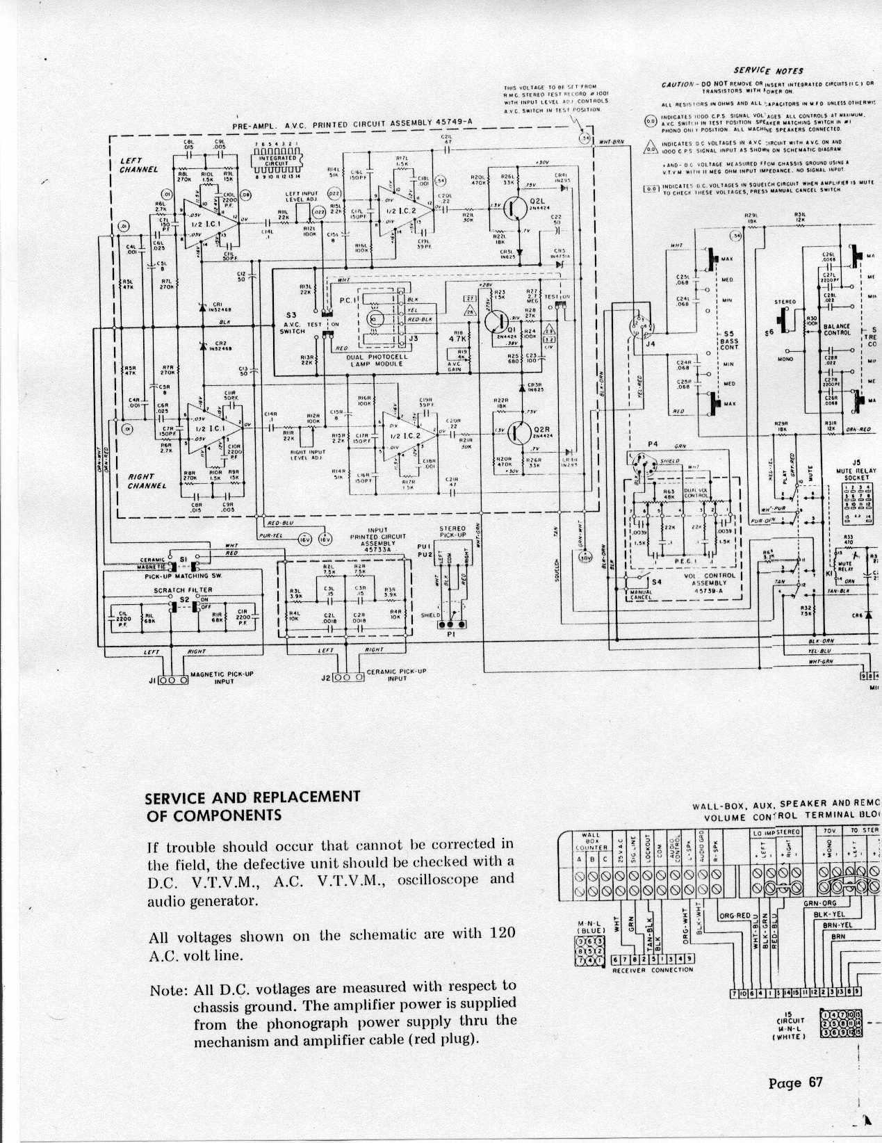

Number two - according to the advertising flyer, this had two actual ICs. One drives the volume control and AVC and the other is the left/right channel amplifier.

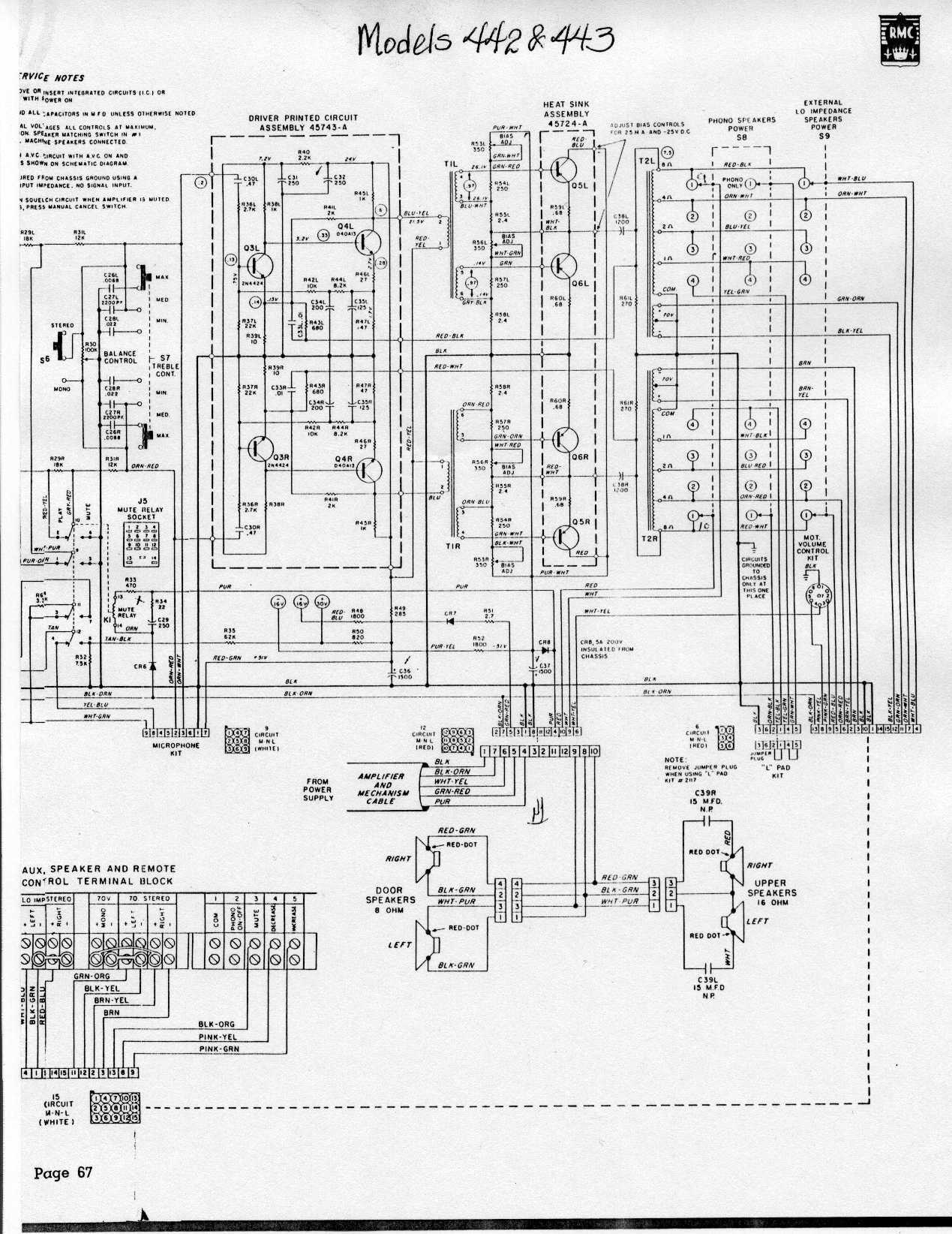

"Dog" that model used the same electromechanical mech as all their post 1963 machines. The main weak spots are the gripper motors which seem to burn out (on all R-O's right up to the end of the vinyl line) and the need to regularly clean the sliprings on the memory unit.
Looking at the schematic here:
http://www.verntisdale.com/schem/442-43a.JPG
http://www.verntisdale.com/schem/442-43.JPG
The only IC's are standard op-amps. The one possible problem area is the photo-attenuator cell in the agc section. I have these in service in the Rowe MM-1 amps and they have not yet failed. I can't determine from the voltages on the schematic or the numbers on the parts list if the output transistors are germanium or not. If germanium they can be costly to replace.
