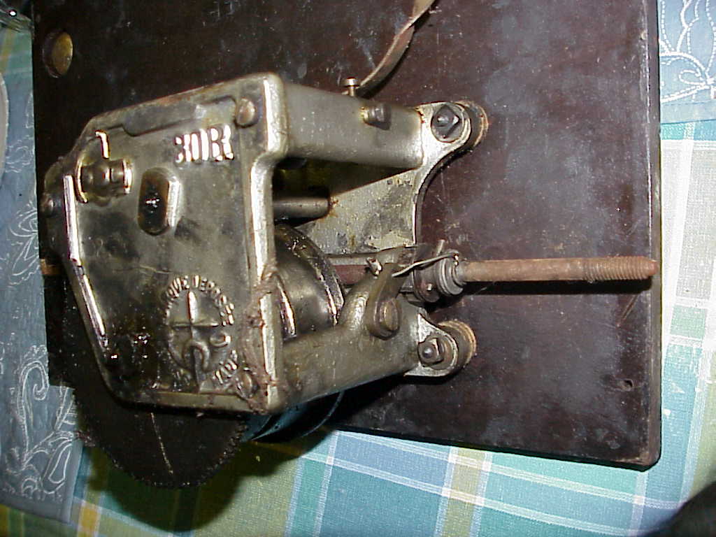

Can you post a picture or 2? If you remove the motor board & photo both it & the motor, it would be a big help. I probably have both the crank & platter, but need to make sure with a photo.

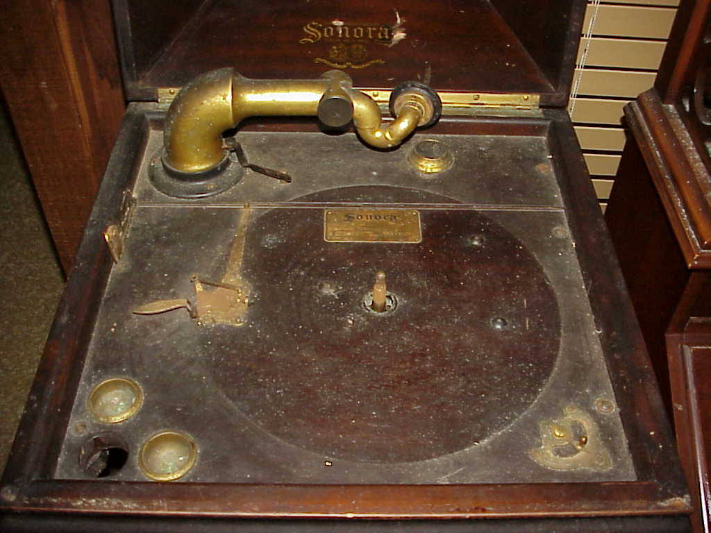

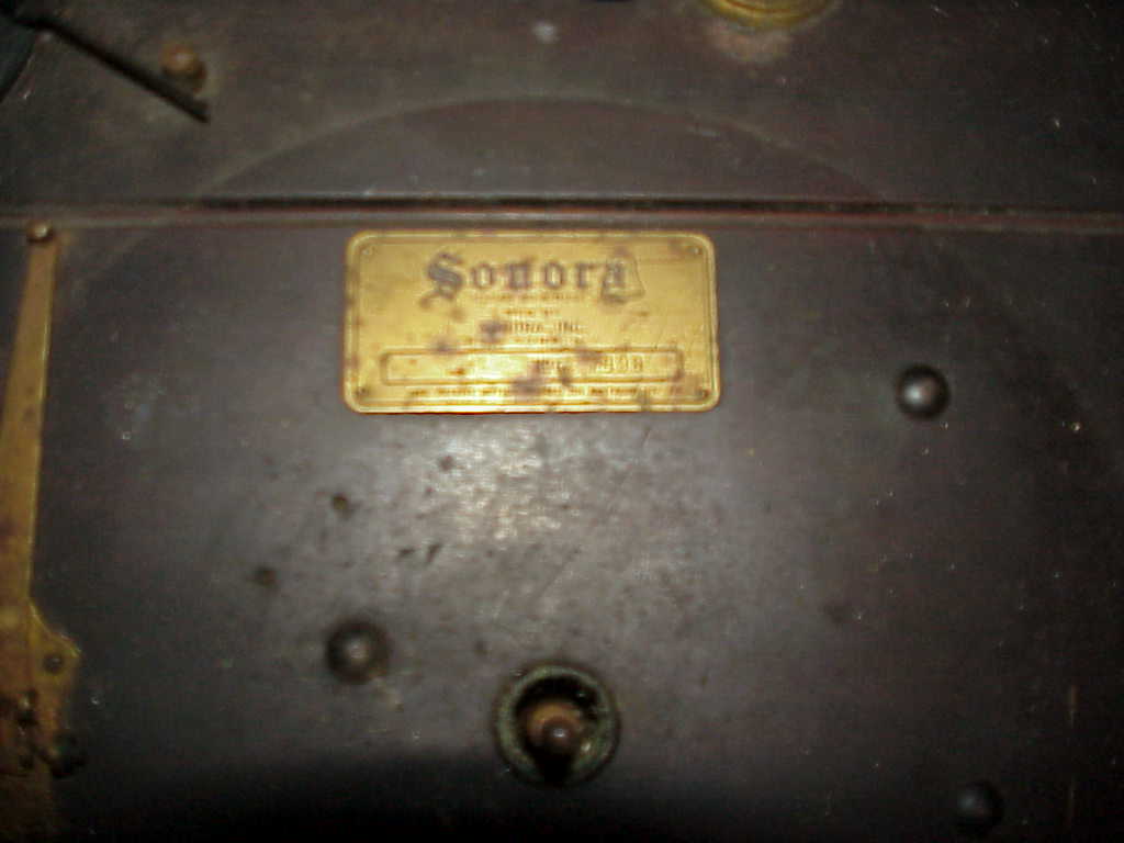

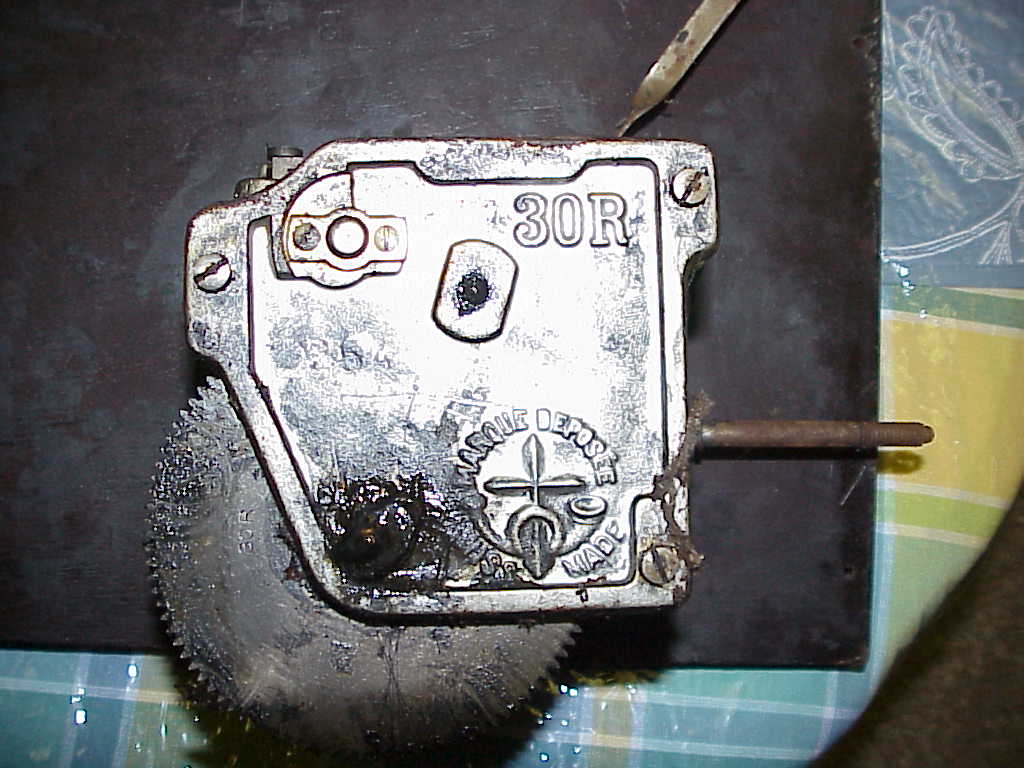

Here are some images of the Sonora Model g 7898 Motor Board and Motor.
Motor and crank shaft
Motor
Motor Board
Motor Board and ID plate

Thanks for the photo's. I want down this morning to check- I have many Sonora tables & cranks that would work, but to my surprise, none are gold plated: all nickel. Best to hold out for the proper parts. The Union Show is coming up in a few weeks- someone there will prob. have what you need.

I'd have to see the whole cabinet, but based on your description, it sounds like you have a Sonora Grand model. (I think that's what the "G" stands for.) It's similar to the Baby Grand, but equipped with gold plated hardware, and the cabinet is taller & larger.
There's one profiled on this page -- http://forum.talkingmachine.info/viewto ... f=2&t=6665
A 1918 ad appears on this page -- http://news.google.com/newspapers?id=hB ... raph&hl=en
These would have been produced from the late teens through the early 1920s. An exact date would be hard to pin down, since no sales or production records exist.

Thanks Joe for the information. The 1919 newspaper ad nailed the ID on my Sonora. It is definitely a Grand.
