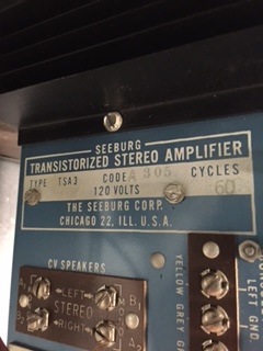

The side of the amp reads Type: TSA3 Code: A305 Cycles: 60 120 volts

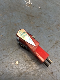

I purchased needles from needles4jukeboxes.com "Seeburg Stereo T Needles" .7 mil Diamond

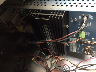

The speakers are attached with what I believe are the original cables.

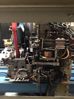

So a little back story on the machine. I got it for $75 from a nice lady in a small town. The glass was broken and they said that it would play but only if you put a record in manually. I toyed around with it and I got it to make selections and play on it own. I am super excited to get this machine fully functional.

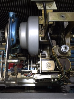

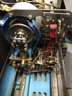

Here are a few photos of what I am working with. I am available most of the day to send info and photos. Thank you very much for your time I appreciate it.

So further inspection of the mechanism I discovered a spring that was hanging there. I did some research and it turned out to the Trip Switch Counter Balance Spring. I attached the spring to the rear of the Trip Switch and so far I am able to play both A & B sides with good sound quality. I ordered a gram spring tension gauge to make sure that I have all the pressures correct.

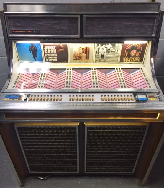

UPDATE:

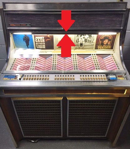

Everything seems to be running great! I replaced the glass with some Plexiglas and it looks great. Thanks everyone who helped me hash out the issues with the machine. :mrgreen:

However, I am looking for something that will block out that fluorescent light over the album covers. There is one on the bulb now but it covers about half of the light bulb. Anyone know what they are call or where I can find one? I googled and I couldn't find what I was looking for.
