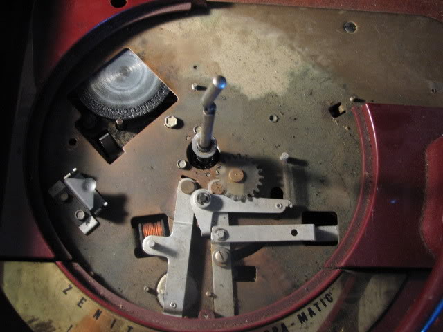

It sounds as though an intermediate idler wheel is missing but I can't say for certain without some pictures of what you are dealing with.

by tennsion » Sun Jul 13, 2008 7:30 pm
Here is a picture taken from above that shows what is just underneath the platter. There is definitely some entire assembly missing, but I don't know what. If anyone else has a picture from a working or intact Cobramatic it would help me to see what is missing and if I can't find a part, I might be able to construct one. Thanks again.

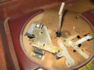

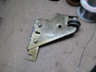

This should answer some of your questions.
This is where it goes.
The drive you are missing.
Zenith Drive 011.jpg (88.22 KiB) Viewed 2964 times

Did you get your Cobramatic working yet. As you must have figured out, the large wheel is spring loaded and rubs against the changer base plate when the platter is removed. The weight of the platter on the intermediate vertical wheel pushes it down so it can clear the base plate and turn freely, and the speed is adjusted by sliding the vertical wheel to different positions along the radius of the larger wheel, a really ingenious and simple way of achieving continuously variable speed control. These changers were a very advanced design, they also featured an electrically activated trip mechanism and the last ones produced in 1957 had automatic shutoff and a lighted stroboscope.
If you still need the vertical wheel part, I have a 1955 model Cobramatic which is damaged and I could probably part it out. You can email me directly at famesteve@yahoo.com if you'd like.
