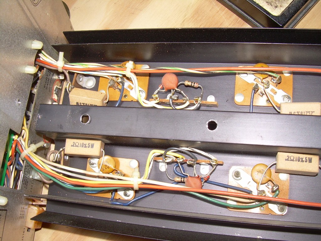

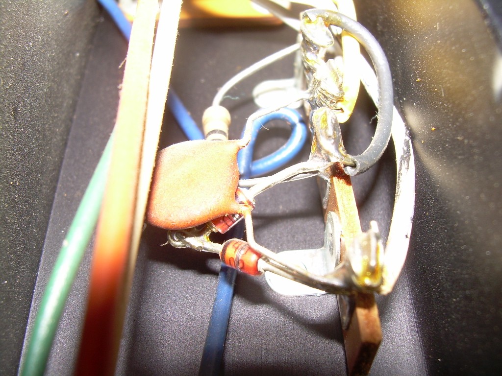

After examining under the heatsink, it looks like my amp is not code B like I thought. It looks like this has the later biasing circuit.
I did all of the checks on page 39 of Tony's SHP book. Everything checked out OK except for items g and h (after making the noted corrections in the book). Tony states that these measurements should all be under 1 ohm. It looks like these measurements are checking the connection on the edge fingers of the driver board. However, when I did the measurements for g and h I get a reading of 100 ohms. Looking at the schematic, it looks like I'm reading the 100 ohm resistors R5176 and R5199. Is this correct?
