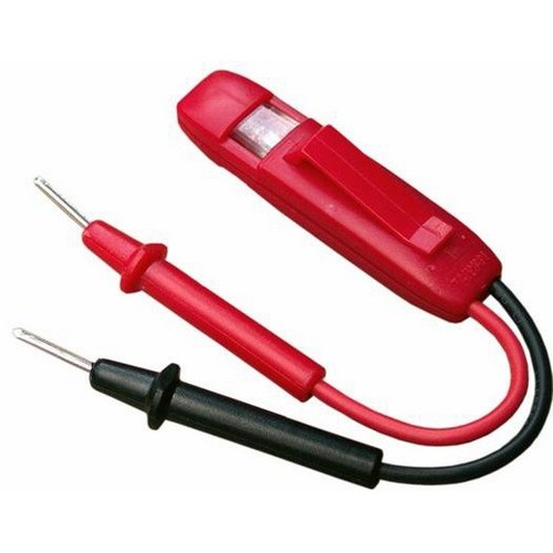

Buy yourself an inexpensive AC line neon tester.
Chop off the probes, and wire on a cord to it.

I have one. But it's too dim to see the marks unless I turn off the room lights.
I found some LED Christmas lights that blink at the power line frequency.

MattTech wrote:Buy yourself an inexpensive AC line neon tester.
http://www.morrisproducts.com/images/59020_l.jpg
Exactly, I would do the same.
