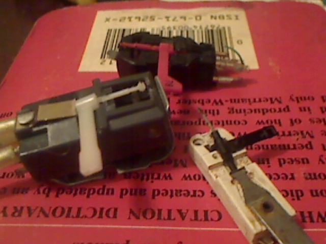

I seem to have the same model. I am new to this...I have the player and a new needle but think I need a cartridge?! Can't tell how the needle would go in...
Re: Sears and Roebuck stereo/ phonograph question
by MattTech » Sun Mar 23, 2014 4:21 am
Looks like an EV 150 with a missing yoke.
Need a new cartridge now.
by Bobby Basham » Sun Mar 23, 2014 7:38 am
On these cartridges, the needle slides in at an angle under that metal clip and snaps into place. You should hear the "click" when it is properly seated --BB

Adunham
Posts: 5
Joined: Sun Mar 23, 2014 12:16 am
Location: Wooster, Ohio, USA
by Adunham » Mon Mar 24, 2014 3:17 am
MattTech wrote:Looks like an EV 150 with a missing yoke.
Thanks, Matt! What is a missing yoke? Unfortunately, I snapped a piece off when I got it...you can see on the picture the broken piece. It is the little black arm piece that comes out of the silver part (end of the arm) on the top of the picture. I have the silver "ball" that screws on to that black piece but I snapped the little black male part that screws in to the "ball". Confusing??
Is that the cartridge in the picture? Or, am I missing the cartridge??

Bobby Basham wrote:On these cartridges, the needle slides in at an angle under that metal clip and snaps into place. You should hear the "click" when it is properly seated --BB
This is helpful Bobby! So that is the cartridge right there?

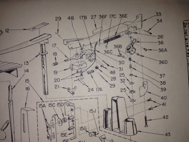

I snapped the #17 piece in the picture called "Retractable Cartridge Bracket"...
by MattTech » Mon Mar 24, 2014 4:36 am
I wouldn't worry about the "retractable" feature as long as the cartridge is mounted properly and plays.
You'll need a whole new cartridge though.
EV 150D, maybe a 149D. (lighter tracking)
Since I don't know offhand the tracking specs of that particular setup.
