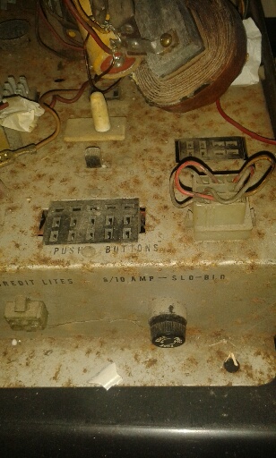

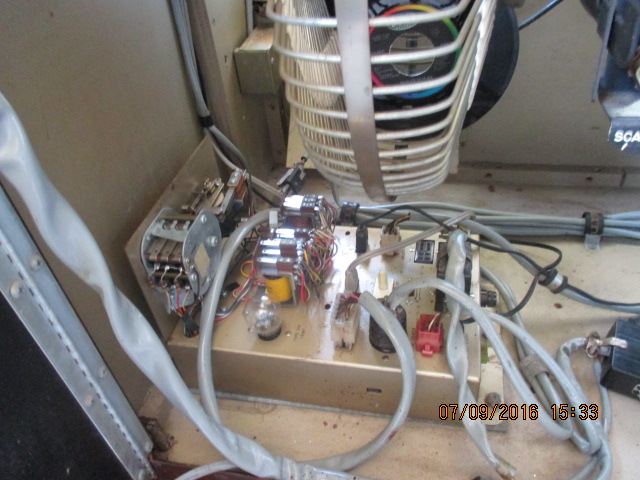

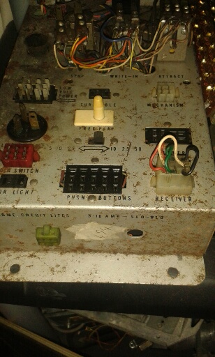

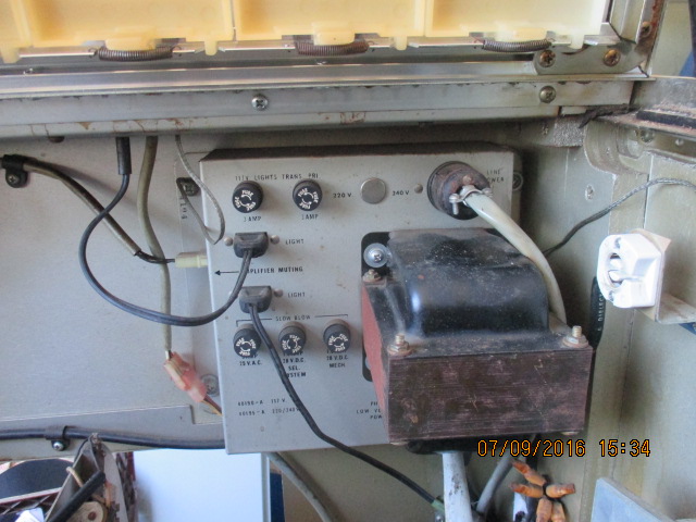

Re: Rockola 425 Write In problem
by ds100h » Sat Jul 09, 2016 10:29 pm
Clones
I am attaching 3 pictures, hope you see what you are looking for.
by Ron Rich » Sat Jul 09, 2016 11:45 pm
Darrell,
A couple of questions--
Did you just acquire this phono, or is it one that- was-working, and just quit ?
Where is the cover for the junction box relays/price unit ?
Is the lamp good--contacts good ? If I am not mistaken, this is in the WI circuit and should "flash" when a selection is made -- Ron
clones
Posts: 581
by clones » Sun Jul 10, 2016 12:42 am
Can't really make it out from the photos but there should be a jumpered plug when there is no stepper connected, might be labelled receiver on the unit, I will dig out a few spare units I have and post a photo but if the plug isn't there or if the plug if there is not seated properly the machine will try to write in but not select, otherwise the only other thing I can think of is to clean the stop relay contact points

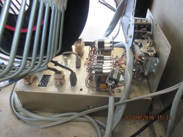

Posts: 581
by clones » Sun Jul 10, 2016 12:59 am
Photos of the write in units
