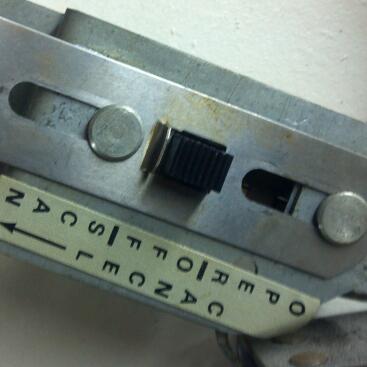

First things first: when I put the Scan switch to "Scan", nothing happens, except the turn table spins with the record on it. The manual says to push the Scan Switch down to the scan position and the magazine should move until I release the switch. I'm not sure if maybe the switch is stuck...it doesn't really seem to move down or inward much (not sure if they meant down as in the direction to the floor or down as in push the button in).
Scan Switch.jpg (16.44 KiB) Viewed 1446 times

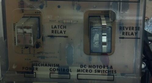

Either way, it doesn't move much. Is that how it's supposed to be? I've also tried rejecting the selection that's already on the turntable by using the cancel feature...but the phonograph arm doesn't lift off the record. Then there's the Mechanism Control box...the manual doesn't talk about it much, and it looks a bit scary to mess with. Could that hold the key to what's wrong with it? Or at least, would it some how move the magazine?
Mechanism Control.jpg (16.8 KiB) Viewed 1446 times
Is there a way to manually move the Magazine, like doing something with this part:

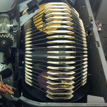

Secondly, when I opened the inside of the Rock-Ola, I noticed they never filled the magazine...which the manual says it's "EXTREMELY important" that it be filled to capacity. I'm guessing for balance issues. Could this also be part of the problem? I can only add records to the top of the magazine, though, since those slots are open...but there are also slots I can't reach that are open. Any ideas?

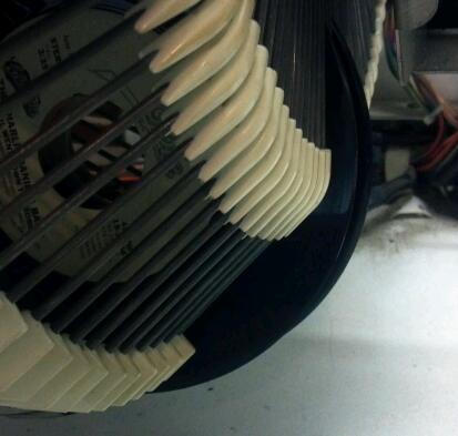

And lastly, here is a picture of the records they said were "jammed":
Jammed Records.jpg (19.91 KiB) Viewed 1446 times
However...they don't actually looked jammed...I can easily lift them up into the slot. That's how I thought I might fix it before I started messing with it: Hold the records in the slots as I use the Scan Switch to bring them up...but that doesn't do anything. So are the records just not jammed and it's another issue?

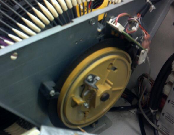

Ok...I realized my post above was rather long and complicated...but I think I may have narrowed it down some? I'm not sure why I hadn't thought of this earlier, but I looked on youtube on how the insides of this jukebox is actually supposed to work, and noticed something.

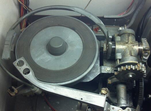

It's like the jukebox is stuck in play mode...only the needle isn't on the record to play it. It never resets itself. Is there a way to manually get it to move? Here:
Stuck In Position.jpg (30.13 KiB) Viewed 1422 times
This is the only position it stays in...Could the gears be stuck?

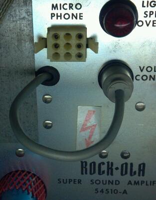

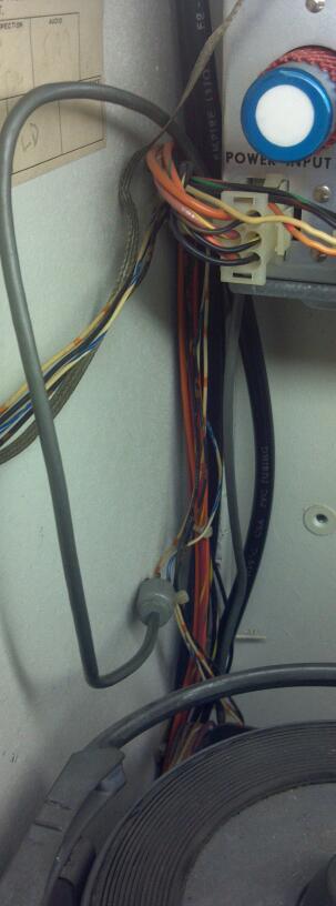

There's a thick grey cable coming up from the bottom of the jukebox, attached to a "Volume Control" box...but it's not plugged in to anything. I can't find where it actually plugs in to:
This is what the end looks like:
End of Plug.jpg (7.51 KiB) Viewed 1422 times
The only other cable I saw like it was this one, already plugged in:
Volume Control.jpg (19.88 KiB) Viewed 1422 times

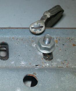

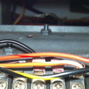

And lastly, she noticed something else not "plugged in". It's at the very bottom, near the Audio Distribution box. It's near the back. It's this black wire...but I'm not sure where it goes...or what it does.
Possible Problem.jpg (12.34 KiB) Viewed 1422 times
Possible Problem 2.jpg (19.5 KiB) Viewed 1422 times
You can't see it that well in the second picture, but it's right above the screw in the back. Should it make contact with the screw?

I've had limited dealings with those later R-O's but since no one else has stepped up I'll offer some basics.
First, if the machine was tipped backward and records spilled out, there is a strong likelyhood that they jammed the basket and blew the low voltage DC fuse.
Your 'scan/service" switch appears to be all the way down in the "scan" position. Have you tried to slide it up to "operate"?
It is a bit odd that the turntable is turning and tone arm is in play position...This may indicate that the gripper motor has blown the low-dc fuse and not the basket motor.
At this point I would first look for the fuses and examine them for any blown ones --be sure to replace with the values recommended on the chassis only--
Often with R-O's the gripper motor develops shorted turns in it's armature and while they will still run for a while, the current drain gradually goes up and eventually starts blowing the DC fuse. Dumb operators often just put in a larger fuse just to 'get it going again' and left it that way. After a while the motor will become shorted and that can cause real damage if a too large fuse has been used.
You might try removing and unplugging the gripper motor and try turning the gripper's gear to see if you can get the bow back over the record basket and fully open. if so, it should then be possible to get it to scan. Do this after looking for a blown fuse.
If you replace a fuse and it blows again, unplug the basket motor as well and try the fuse again. Rock Ola motors are notorious for going bad, but generally it's the gripper motor that goes first.
The other connections you mentioned are not involved in any of this. The braided wire with a spade lug is to ground the chassis that is near it. just put it under that bolt.
Beyond this, you'll need some one with more expertise in Rock ola machines.

I have recently restored a Rockola machine myself, and re-iterate what Rob has said.
First things first. You are correct, the machine is in the play position, but strangely as Rob said
there looks to be something odd about the scan switch, it does look as though it's stuck in the scan position,
I think it should return under spring tension.
You do need to get those motors checked before going any further really.
Personally, I would unplug, then drop the motors from the chassis, this will allow you to easily check them properly.
They are DC motors (about 28V DC), and normally draw about 0.5 A when running off load.
Once the motors are out, try turning the gripper gear to return the bow to its home position (over the basket).
You should then be able to rotate the basket easily using its respective gear.
Note, you will not be able to rotate the basket or gripper by hand with the motors attached, due to an internal worm gear
in the motor gearbox. There should be however a knurled knob on the back of the motor to allow the armature to be turned manually.
As Rob has said, I too think it highly likely that one of the motors may be faulty, and has taken out a DC Fuse.
How are your electrical fault finding, and schematic reading skills ? Do you have the full service manual ?
