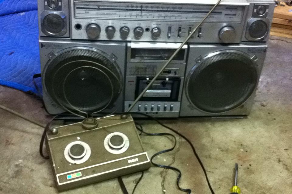

if i press the keyboard some pins will pop' after fully cleaning keyboard' but still will not push pin back' gonna fully clean wobble plate contacts and maybe reflow solder on W.I & R.O arms this machine was sitting for a very long time when i drilled out locks this was what was inside the jukebox too funny' and thanks for all your help
