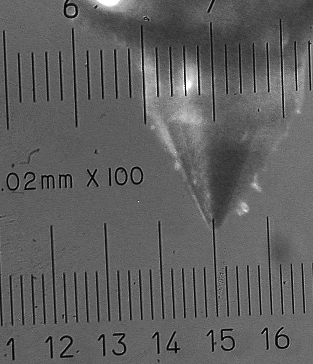

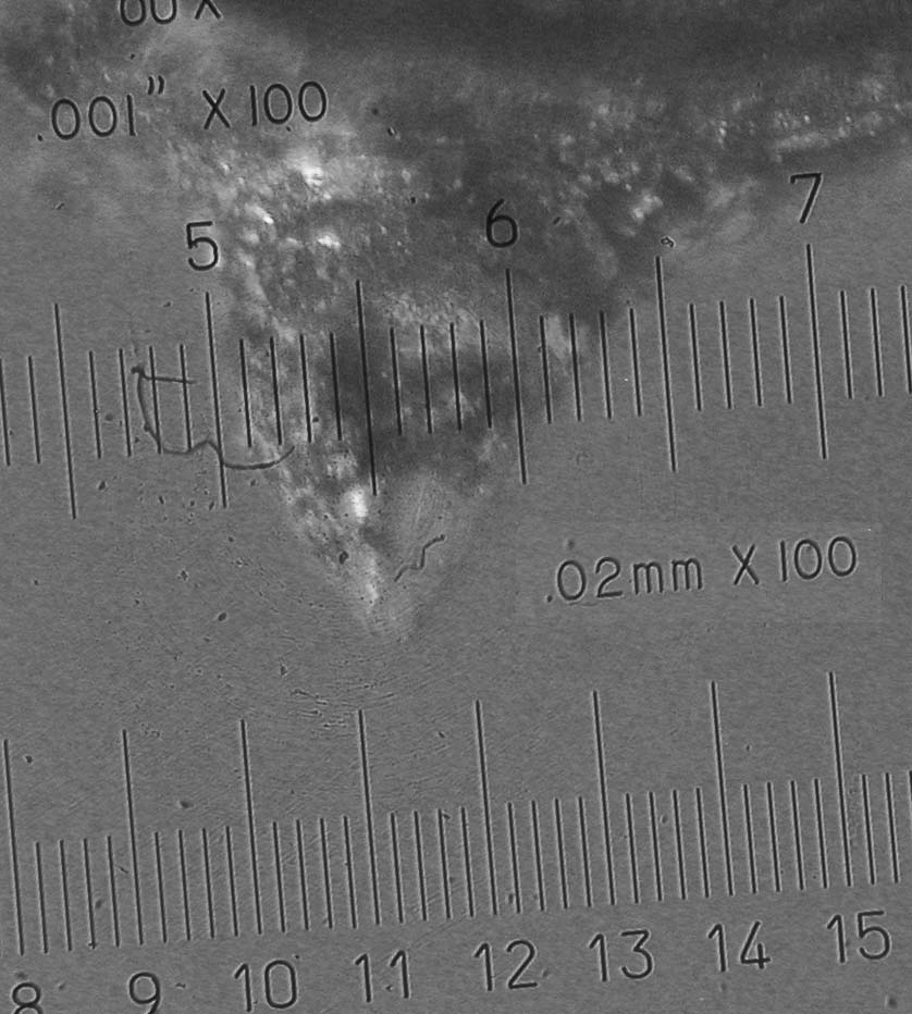

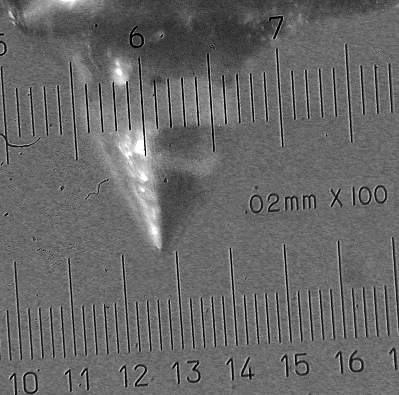

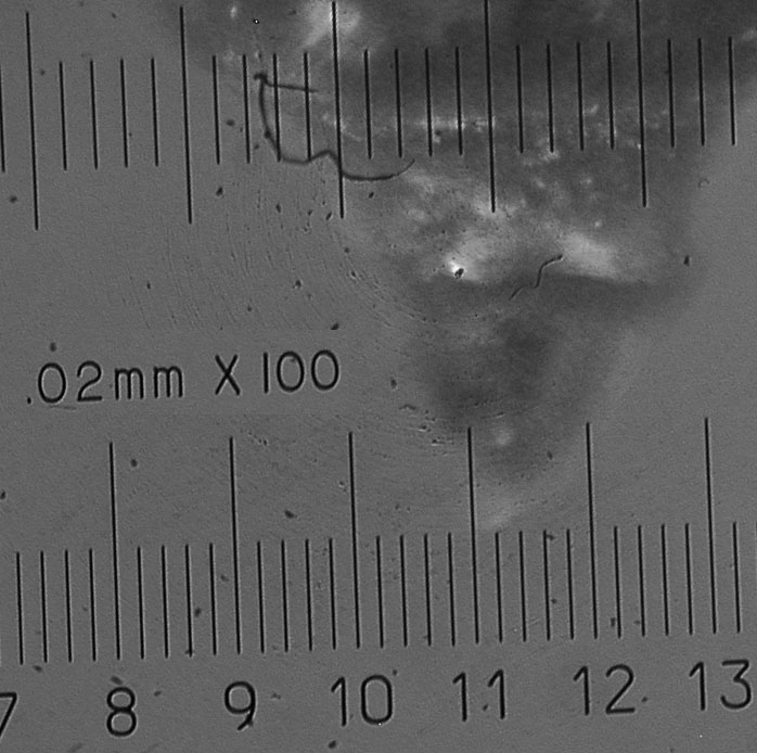

I have recently got a Seeburg AY160. I was curious about the T diamond Red Head cartridge needle condition since their age is unknown. I got out the old microscope to take a look. Here is what I found. Sorry for the blurry photo, I couldn't seem to keep the camera from focusing on the reticules instead of the needle.
Right needle, side view
Right needle, top view
Left needle, side view
Left needle, top
Apparently the left side has been taking most of the use. It looks like my jukebox is "grounded" for a while. :(
