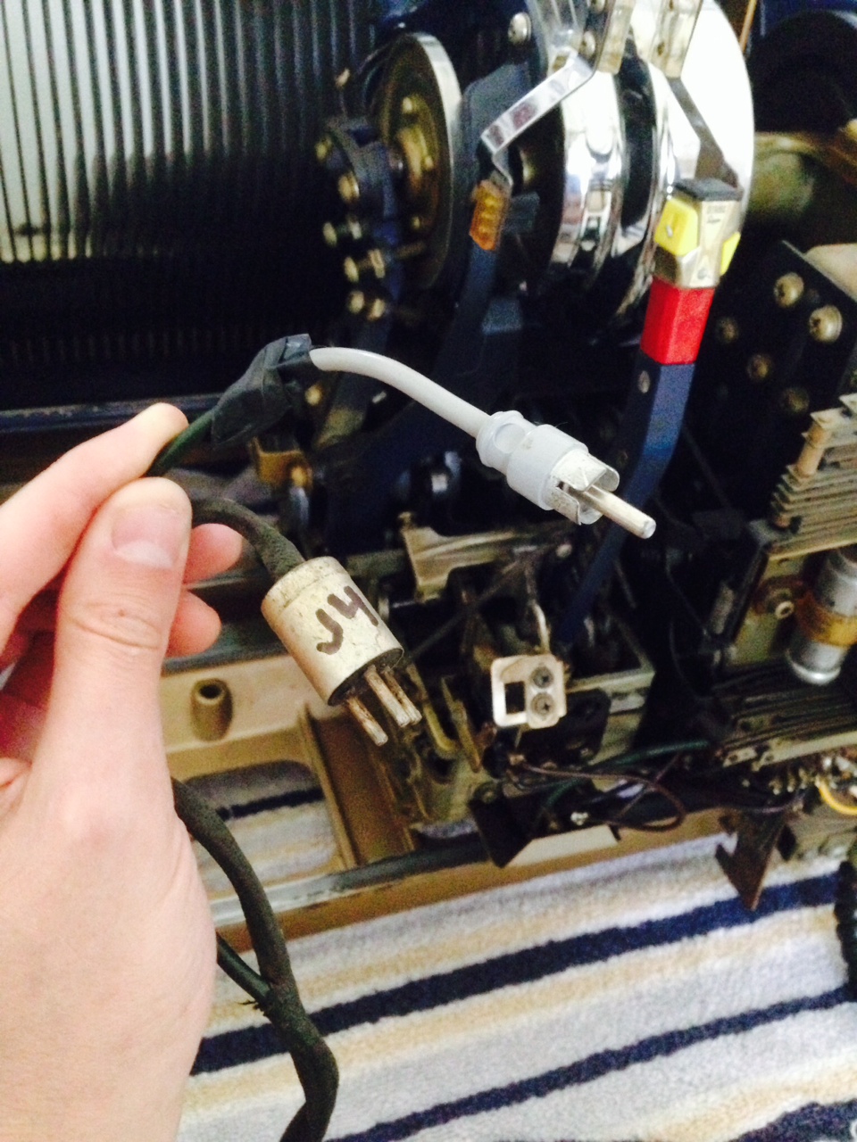

Sometime in the 80s this 100R was converted, or hacked, into running a solid state amp. Is it possible to get an original connector for this hacked together RCA plug? Or was it always a mono RCA? If so I can just install a newer cleaner male plug. This is coming from the selector unit and was plugged into the SS amp.
The 2 prong speaker output jack plug was also cut off, however that was kept inside the cabinet.
Re: Seeburg 100r Recap question/s
by Rob-NYC » Fri Sep 19, 2014 3:28 am
The "R" was mono, while it could be converted to stereo as I did with one,Tthat has not been done with yours.
I see the original tonearm assembly hosting a retrofit stereo cartridge. That -can- be good but there are a few caveats. Most of the adapters I've seen wired the two channels together in parallel. That is best for reducing distortion. A few wired only one channel, or worse, wired the two in-series in order to get more output. This emphasizes distortion from stylus and record wear. That cart appears to be the later types used from 1966-on. It has around 460 per channel of DC resistance on a meter, If properly wired parallel you will see half that on a meter.
Another problem is balance. The original mono cart is appreciably heavier than that later stereo one. If the adapter doesn't add enough weight, or the counterweights have not been ground down the arm will bias toward the approximate center point of a record and cause distortion and wear at the beginning and end of a record. Select a slot with no record and let the arm settle. Does it bias toward the middle? Turn off power and move the arm towards the turntable as far as it will go, release it and see if it swings back to that center point. The arm should be free to follow the record and not biased in any direction.
The tonearm plug was originally an RCA.
I suggest removing the silver capacitor that is across two motor connections at the right of your pic. these have been known to "pop" -sometimes violently.

Just cut it out. It was originally there to reduce noise when the mech reverses. Seeburg eliminated them sometime in the early 1960s.
