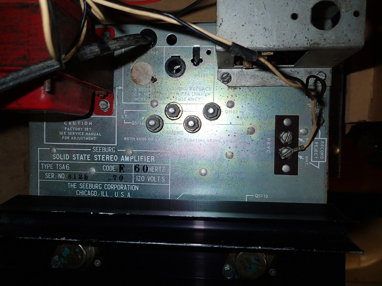

As I had to source a pair of Bass speakers (someone had replaced both seeburg ones with odd car speakers in the past) and had sourced a better TSA6 Amplifier, I noticed that the amp is rated up to 32w per channel, but the speakers are the same as in my SS16o Showcase which is only 25w per channel.
(note - both Amp and Control Centre say 120V but I have re tapped the links on one transformer and replaced the other to bring them both to 230V)
at present I have tapped the speakers to the 16W terminals, my main question is - will it be OK to connect them to the 32w tappings?

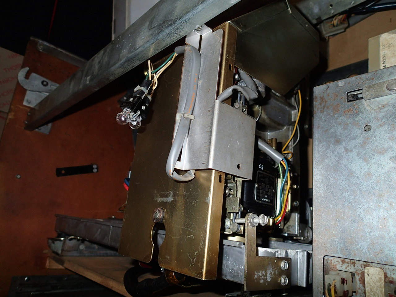

Question 3
The "Selection Playing" lights work but it seems I have no bracket or parts on the mech to mount them
Does anyone have suitable parts for sale, or perhaps able to photograph theirs so I know what I am looking for please?

This shows the 2 colour banding in the speaker cloth
This shows the Selection Playing lights as they remain since I bought the machine - there is no bracketry for them (although there is still the poularity meter brackets etc which do work) - can anyone send picture of the correct bracketry or know of a set available?
Selection playng lights (incorrect!) SE100 Goldenjet.JPG (264.04 KiB) Viewed 521 times

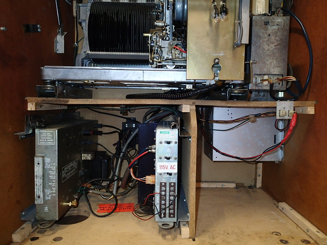

This shows the Amp , Control Centre and Mech in my SE100 Goldenjet
SCC9 and TSA6 Amp in my SE100 Goldenjet.JPG (280.89 KiB) Viewed 521 times

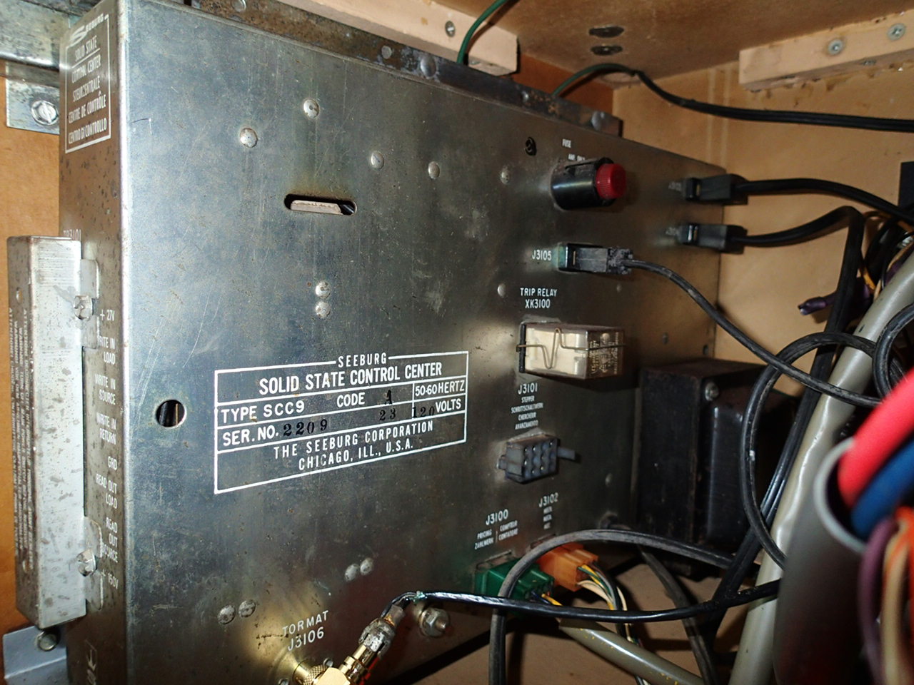

This is the Control Centre SCC9 fitted to my SE100 Goldenjet
SCC9 Control Centre in my SE100 Goldenjet.JPG (278.32 KiB) Viewed 521 times

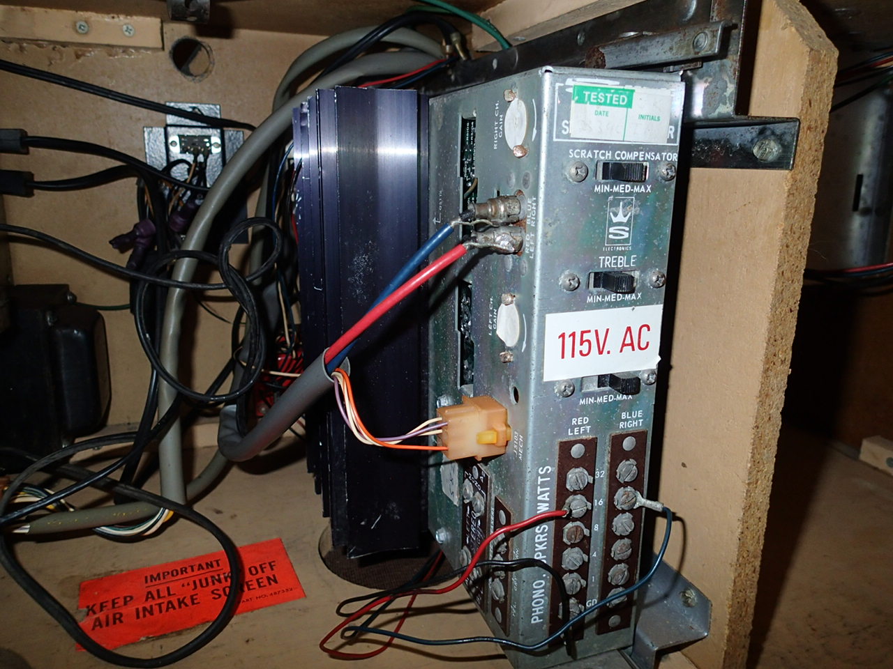

This is the label on the Amp of my SE100 Goldenjet
TSA6 Amp Label in my SE100 Goldenjet.JPG (263.91 KiB) Viewed 521 times
This is the Amp I have in my SE100Goldenjet - Tappings shown set at 16w
TSA 6 Amp terminations in my SE100 Goldenjet.JPG (282.3 KiB) Viewed 521 times

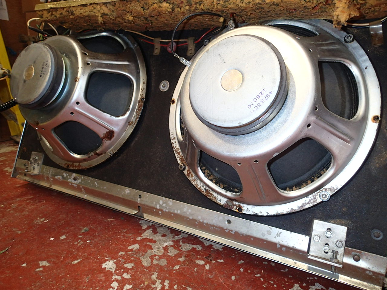

These are the speakers I have sourced and fitted to my SE100 Goldenjet - can anyone identify them and their Wattage capability?
Speakers fitted to my SE100 Goldenjet.JPG (286.18 KiB) Viewed 521 times

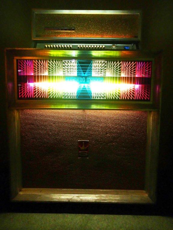

This is my SE100 Goldenjet machine lit up, I have noted that someone has changed the grille cloth compared to pictures seen on line, so I will change that to one with a banded pattern at some time
Seeburg Golden Jet Juke Box Dark S.jpg (80.5 KiB) Viewed 521 times

Kevin e: question 1. Those speakers do not look like what is in the domestic SS160. At any rate, those "32 watt" amps are essentially the same as the 25 watt with just a heavier power & output trans. At best you'll get about 20 watts clean with both channels driven. How to connect the speakers depends on their impedance. The amps were spec'd for 5 ohm loads. If those speakers are either 4-5 or 8 ohm you can use the max tap (32W) and get full power. If they are 16 ohm you can still connect them at full but the amp will only deliver a quarter of the rated power to them.

One esoteric problem i ran into was a SHP- amp with the bass choke removed which caused a slight increase in rumble. Essentially, all low frequencies are made mono in those amps to cancel rumble. Since the amp had been tampered with (red 220V tran on an amp marked 120) checking for the small choke is one thing to look for.

Q1 - Speakers - info about the speakers/Amp. I'll check the impedance of the speakers, very informative - thanks

The speakers you have in the SE, are just fine, and can be connected to the 32 watt tap n the amp--One caution--I do not see a fuse in the amp--did someone move it to the inside-?-it should be no larger then 1 amp slo blo (8/10) if you don't "crank" the volume up).

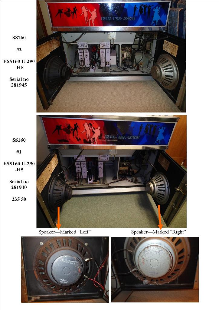

To clear up the curve ball I started - I have attached a picture of both of my SS160's and their speakers, both as you rightly say have different speakers to my SE, both have a Black Left and Silver Right speaker. Sorry for the confusion!
to clear up the confusion I caused by not checking what speakers were in my SS160 and relying on my (incorrect) memory - they are different to my SE100 ones!
SS160 Speaker Detail (for info).jpg (115.25 KiB) Viewed 447 times
