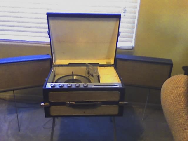

I picked this sweet little blonde up at a yard sale this past weekend. I need the schematics for the amp. Radiomusem.org has an AMP-167AA listed but no 166. Any help would be greatly appreciated. I believe this is a 1958 model.

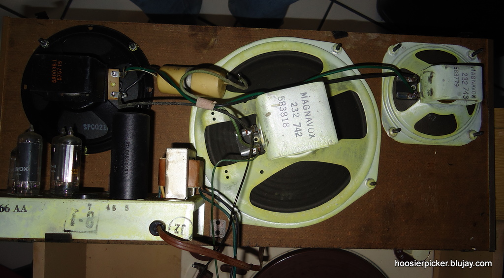

I need to update my Sams Index, but it states folder 417-7 is for your amp. Maybe also check out AG Tannenbaum. Your first pic threw me off with the speaker board in relation to the turntable, but figured it out. I like these old, smaller units. I know stereo came out around 1957, is this a Mono unit with that speaker lineup? If so, that is great that they went the extra mile to house a 3-way system.

Thanks Bobby. I think this was Maggies last mono before they went to stereo. The transformer in the pic is an output transformer. There is no step down power transformer, just a rectifier tube. Legs are heavy duty on this unit.

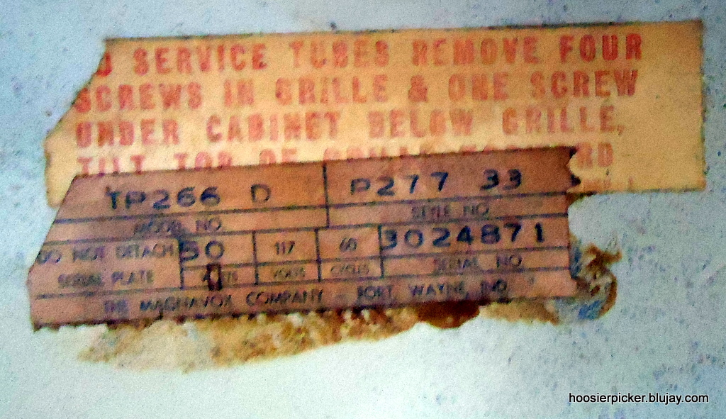

Oh my this is absolutely amazing! I have this same exact unit sitting in my room right now! I'm currently 23 years old and I've been interested in record players and 78s since I was a little kid. Other kids my age were into games and playing outside. My idea of fun was my dad taking me to antique stores and me going through rows after rows of 78s and getting old stereos (maily tube). My dad bought me this when I was in 3rd grade. Its been working beautifully for all these years. Recently however, during warmup, it makes a crackling noise sounding like white noise. If I tilt the front out and "pluck" the amp, it will stop and music will play perfectly. I've tried replacing all the tubes and going over all the wiring for the turntable itself. I would also love a wiring diagram or a place that may sell old working ones. I still can't believe I found someone else with one of these. I was beginning to think this was the last one on the planet :mrgreen: . Model TP266D, Syle P27731, Stylus 560187-I. So glad that sticker is still on the inside in perfect condition :D . I'll post a picture of it in the next few hours, time for me to head to work.

Heres a pic of my TP266D:

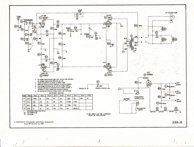

Here's AMP 166AA schematic:

shedradios wrote:Here's AMP 166AA schematic:
Viewing that schematic I find several flaws, it's a hideous misprint.
Missing components and incorrect wiring.
They musta had a hangover that day.
