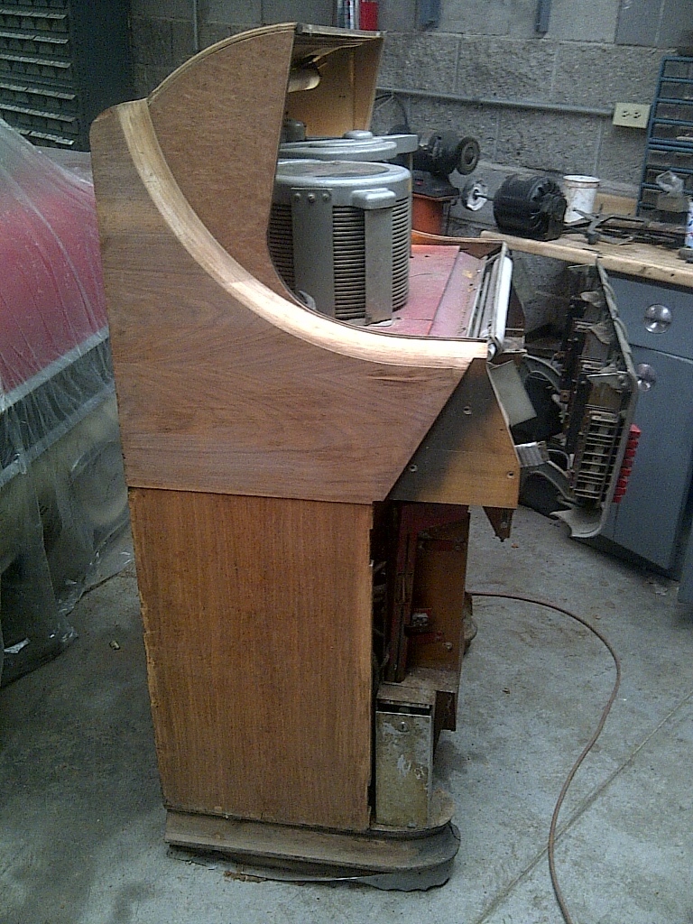

Original drawing with the painted bottom and button side panels
WURLITZER 1250 Juke Box.jpg (34.52 KiB) Viewed 1370 times

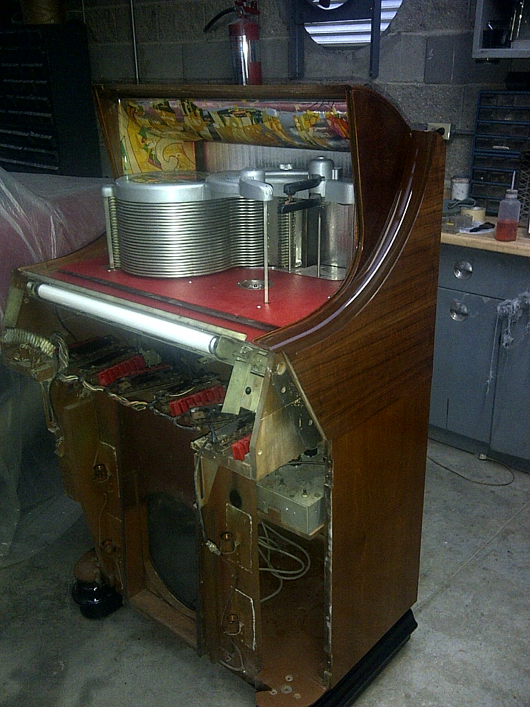

In process
Wurlitzer 1250 vmg.jpg (435.23 KiB) Viewed 1370 times

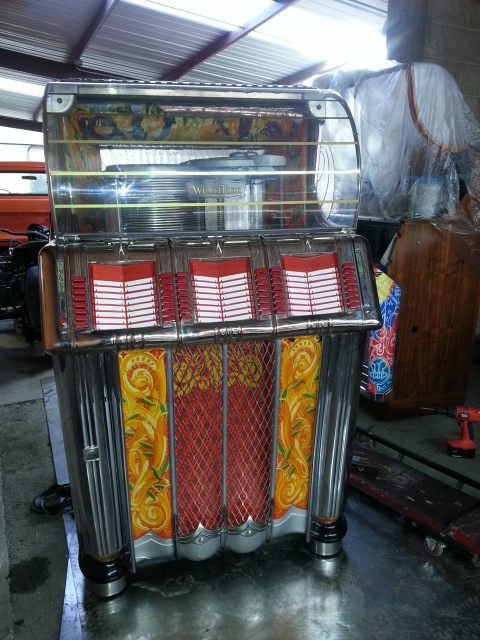

12.10, 009.jpg (405.28 KiB) Viewed 1302 times
12.10, 010.jpg (426.57 KiB) Viewed 1302 times

Re: New member needing help with Wurlitzer 1250 finish
by ken g » Wed Nov 07, 2012 3:38 am
I have restored 3 of these and kept the best most original one . The wood part of the cabinet was done in a typical walnut stain color and lacquer . Your last picture looks fine .
The biggest problem i had with mine was the idler wheel and getting it to go the right speed . I ordered one of the repro wheels and it went way to fast . I had to do some carefull grinding of the rubber to get it right .
These things have that Zenith cobra sound system in them , different animal than the norm . After alot of goofing around with mine it will blast the whole block with deep bass . Its important the correct volume control be there or it will never sound right .
As for the chrome , do either . Mine all had good plating after alot of buffing .
vmg
Posts: 7
Joined: Tue Oct 09, 2012 3:26 am
by vmg » Tue Nov 13, 2012 6:04 am
Thanks for your response. The 1250 is now playing fine, with reasonble volume.
As for the chrome versus nickel, I ended up doing it the exact way mine was. Most of the parts are nickel plated, and only a few are chrome plated.
With the help of a friend we are even recreating the painted metal grill, in bright orange with dark red patterns and the yellow decoration on top. I will post pics once finished.
Victor

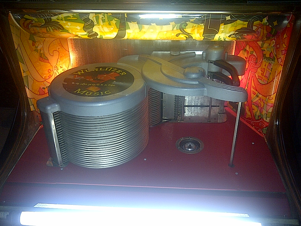

vmg
Posts: 7
by vmg » Sat Feb 02, 2013 8:37 pm
Almost finished! I say almost because my jukebox could use some better parts... like some of the front plastic bottom parts, in case anybody might have one or two lying around.
13.01 013.jpg (210.01 KiB) Viewed 1142 times
