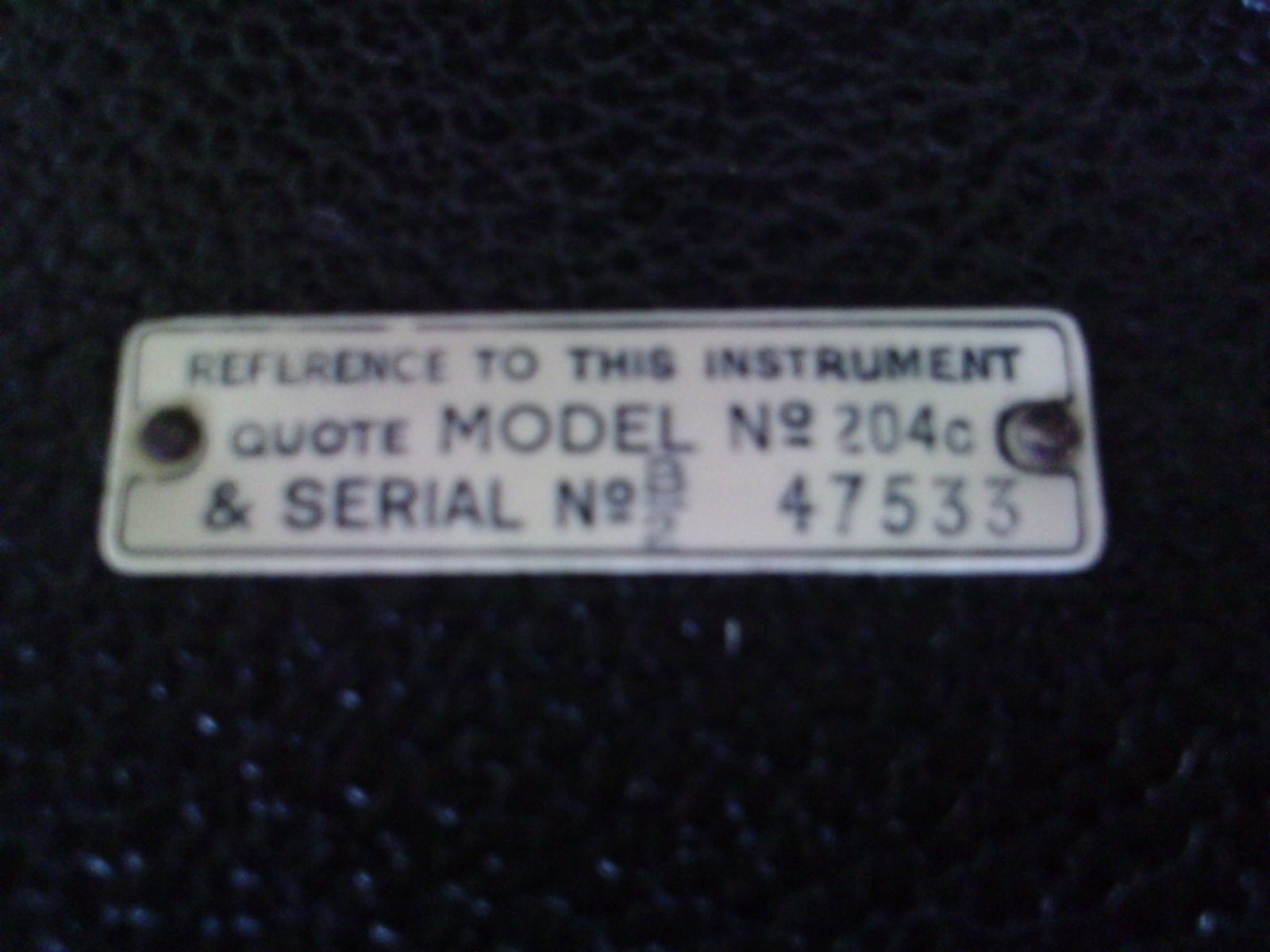

Does the tag under the turntable include a "B/?" number before the actual serial number?
If so, the "B" signifies the year 1936, and the numeral below the B is the number of years after 1936.
So if it says B/14, that would mean the machine was made in 1950.
The tag below shows this is a Model 88Z, made in 1946.

thanks for that my model is as follows,
model No 204c serial No B/2 47533
so is that a 1938 model? and what happened in 1936 by the way??

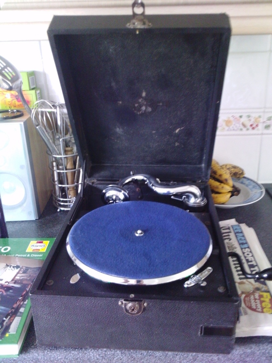

okay silly question time , can i overwind my gramophone?? im a little bit worried of damaging it and some times it jumps and makes a thud type noise when the turntable is spinning? i suspect its not supposed to!
thanks

Not a silly question at all. Yes, you can over-wind it. Normally, though, you'd have to force the crank after it stops. You could try seeing how many turns of the crank are required to play a single side of a ten inch record. Start with 15 or 20, and go from there.
But....
If you hear bumps while the motor is unwinding, that's an indication that the grease used to lubricate the mainspring is due for replacement, and the mainspring, itself, needs a good cleaning. If I were you, I wouldn't play too many records until you have this taken care of. There are many shops that specialize in this, and you can have the work done for a nominal fee.
Probably, the motor also could stand a good cleaning and lubrication.
Along this line, if it has never been done, the sound box could probably also stand a tuneup with fresh diaphragm gaskets, and possibly, a new back mounting gasket (where it hooks to the tonearm).

(292.19 KiB) Not downloaded yet
My rather tatty 204 but it works well

(265.73 KiB) Not downloaded yet
my tatty 204
