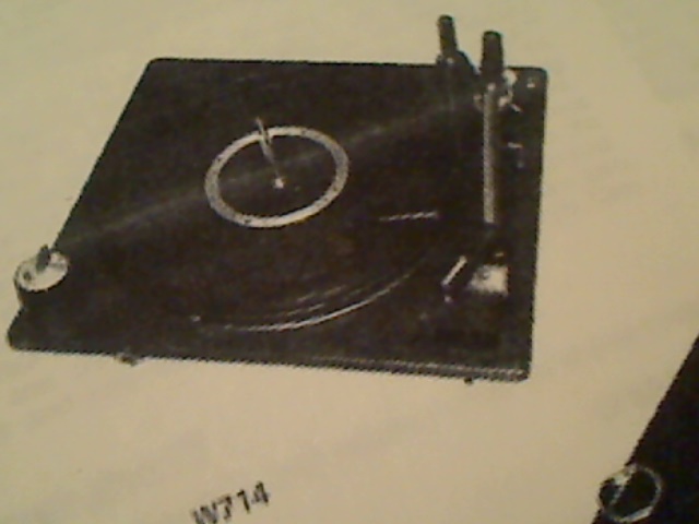

My quirk with these LP's playing slow is that I have a Maggie console, credenza, and two drum table units from the 70's with the newer W700 series turntables, and they all play SLOW. Being a musician myself, I notice these differences. Just drives me up a wall.
I'm still driving an old 1996 truck with Delco AM/FM/Cassette. --BB
W700 Series.jpg (52.17 KiB) Viewed 4269 times

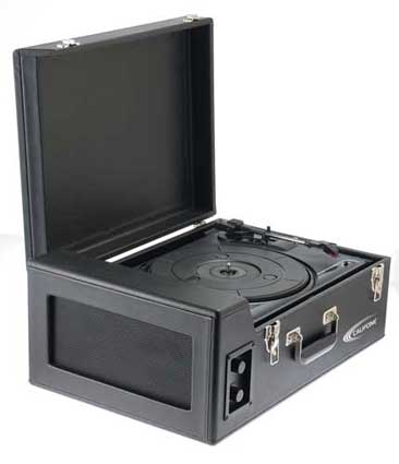

I realize that this is a resurrected old post string, but I've been curious if the currently produced Califone record player is any good --
http://www.califone.com/products/1005.php
To my eyes, it looks suspiciously like one of those horrible Crosley Traveler phonographs. I bought one a few years ago to replace my short lived Vestax Handy Trax, and returned it a few days later because the turntable spun about 10%-20% faster at all speeds. Apparently, I'm not the only one who had this experience (first review) -- http://www.amazon.com/Crosley-Traveler- ... ewpoints=0
Interestingly, my one experience with a used Califone--circa late 1970s--also didn't turn out too well. In spite of the fact that the seller claimed it was "fully restored," it was full of dust inside, and both the volume and tone controls crackled. After a few months, it stopped working altogether.

That Califone that Joe posted about is pure..........garbage.
Indeed just like those Crosley knockoffs.
Trash.

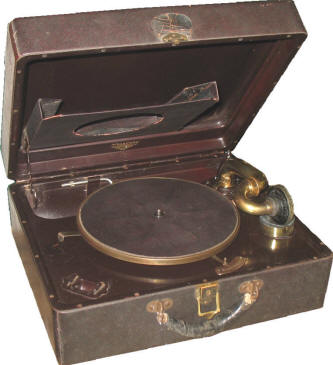

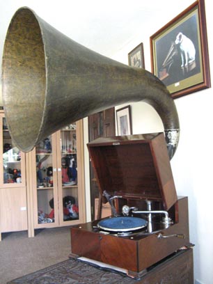

Well, actually, to be accurate--and not to drive this post string TOO off-topic--in order to pick my interest, it would have to have a spring motor, have been manufactured between about 1926-1930, and fitted with an exponential horn. Preferably, I'd want one with about a nine foot horn like this:
But I'd probably settle for something more like this:

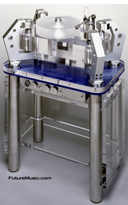

by MattTech » Thu Jan 03, 2013 4:46 am
Aww, Joe, throw away those ugly old creatures and invest a piddling $150,000 in the Basis "Work of Art" turntable.
