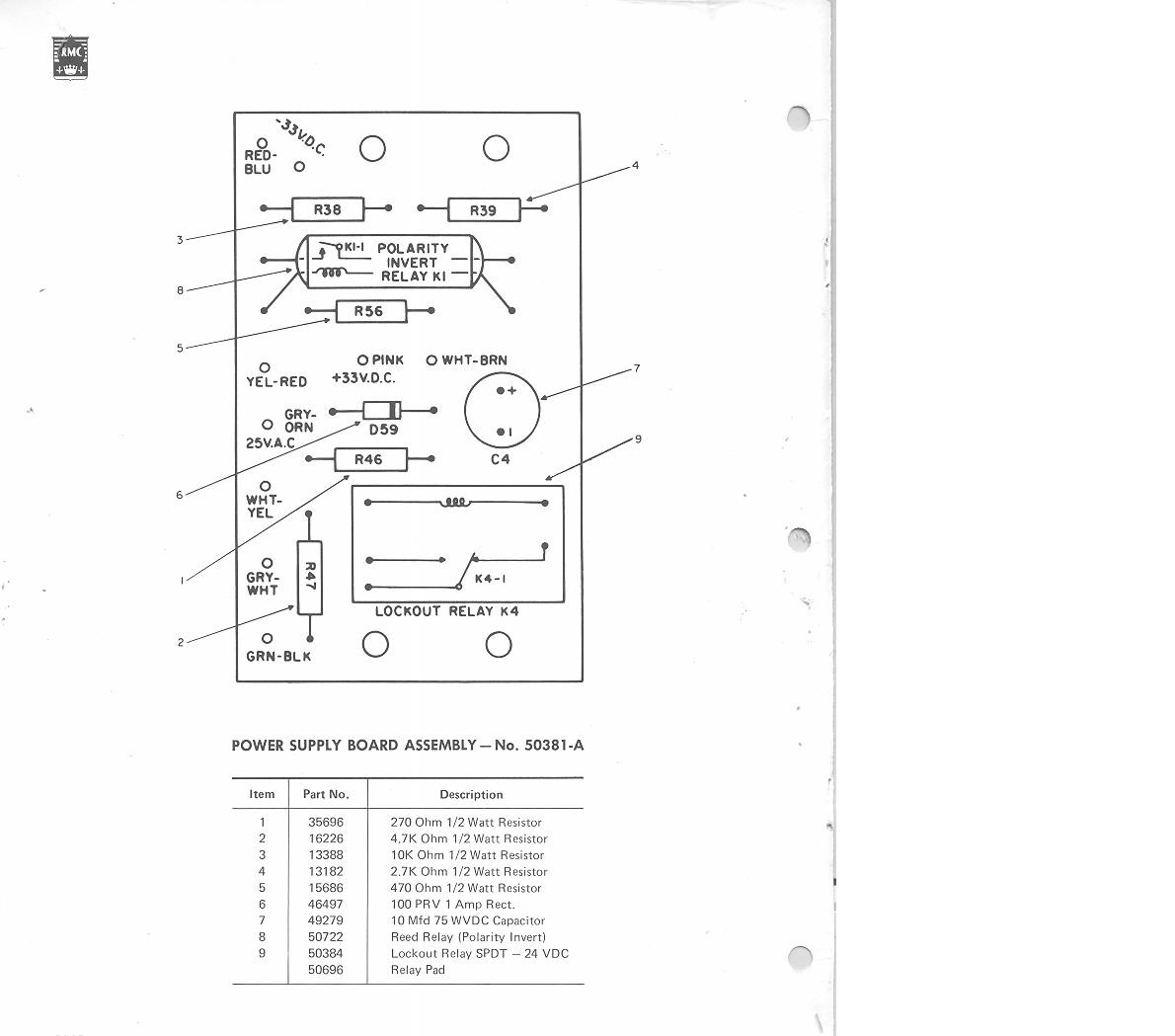

Attached is an extract from the manual showing the board and the reed relay, the only reed relay i see locally in an electronic store are 5volt and 12 volt ones and they don't specify polarity invert

Re: Rockola 507 Wallbox
by Ron Rich » Wed Jun 26, 2013 5:07 pm
Hi Clones,
I THINK that the words "Polarity invert" , refer to the relay's function, rather then it's type.
Is there any number(s) on the relay itself ?
clones
Posts: 582
by clones » Wed Jun 26, 2013 10:00 pm
The relay is black in colour with a cyclinder shape, the following is printed on it ERR 5000 24
regards
clones
by Ron Rich » Thu Jun 27, 2013 12:37 am
OK--remove it and replace it, with one from another working board --or read the schematic and test it -- if it tests bad, you will need to find a cross reff. #, and replace it. Ron Rich
