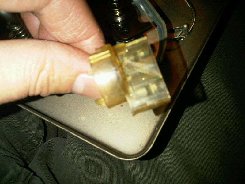

Greetings!
I recently obtained a 1967 Zenith portable record player, model X-560W-1, which has a damaged "On - Off - Rej" switch. Can anyone provide a suggestion on where I might be able to obtain a replacement part? I have attached a picture of the part I'm looking for. Thanks much!

That looks like a V-M switch See this page http://www.thevoiceofmusic.com/catalog/ ... itches.asp

Those are basically the on-off switch you find on the back of an off-on-volume control, with the molded plug attached. I have replaced them with pot replacement power switches and left the plug out entirely, wiring the power wires directly to the switch.
