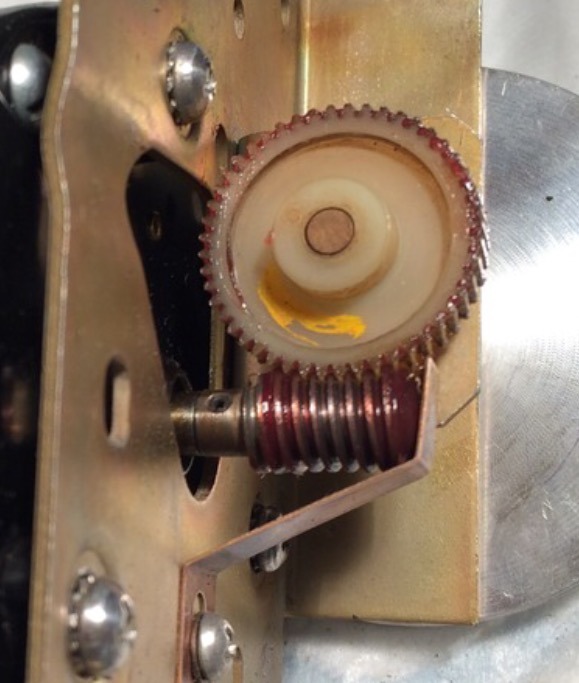

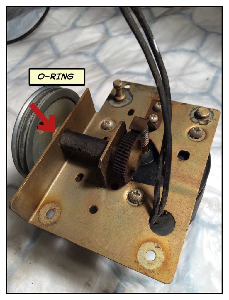

It was the motor and particularly the gear shaft/beltwheel that was causing the rumble.
I opend the motor cleaned it and added one shim and greased inside, adjusted everything for minimum backlash.
Most important fix: Added one rubber o-ring between the beltwheel and bracket side, this removed most of the rumble as the beltwheel rubbed the bracket.

I wonder how long that added belt can last ?--I think I would have seen if I could adjust the gears so the pulley was "centered", so it did not rub ?? Also--gears look dry, should have a small amount of graphite grease, IMHO. Also I think the shaft ( oil hole should be filled), as well as ball bearing should be oiled, with 20 wt. oil. Ron Rich

Gunnar, that assembly looks a bit dirty and bone dry.
The alignment of motor worm and gear can reduce rumble -a bit, the problem is that a too-loose coupling causes wow and flutter as the belts age and and develop 'elbows". Wurlitzer added a snubber in the later models that somewhat addressed that issue, but longterm the flutter always comes back. One "solution" was to add a wave-washer between the flywheel and bearing to add a slight, consistent resistance to the rotation. I didn't like this approach and don't care to add additional friction. However, it does work though using the machine regularly (to prevent elbows) and replacing the belts every few years works as well.

Your observations are correct regarding the dry gears, this photo is 1 year old (just after I disassembled the box).
The photo was just for illustrating where I put the o-ring.
Everything is greased and the gears are also well centered.
There is a new beltwheel installed for 50Hz now.
This is how it looks today:

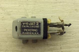

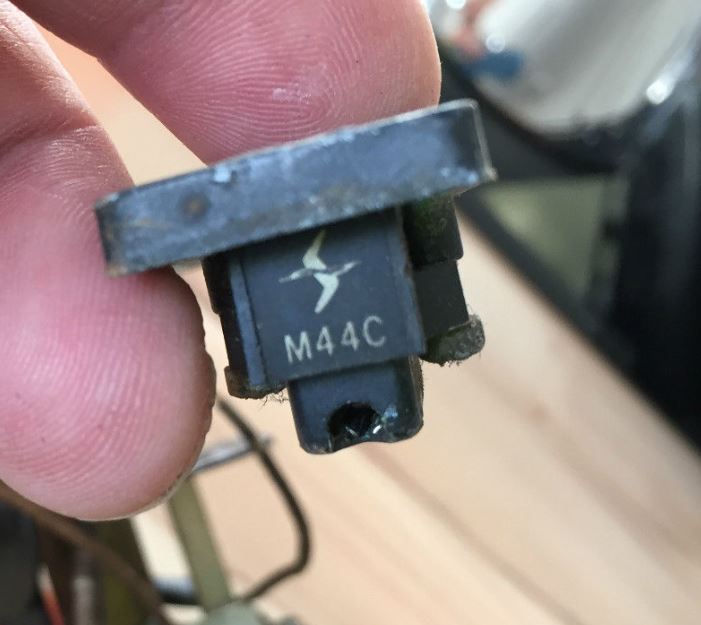

Any commens on this pickups?
Both are out on Ebay/Tradera (nationale site here) now, it's a bargin right now, just a few bucks.
So I can definitely take a chance here!
Do theese old worn pickups normaly works fine after 30 years?
Any pros/cons regardig the two below?
Shure M44 C
Pickering V-15/AT-2
Follow my Wurlitzer 2310S renovation here:

Yes--Pickering is out of business--has been for years now-- Shure is still operating--under recently changed ownership--and I believe still makes that cartridge-- Ron Rich

The Pickering V15AT2 is the better choice with regards to mounting in that arm. The clearances are tight and the cart body is lighter than the Shure. While Pickering Co was sold repeatedly over the last 20+ years it is only recently that the current owner has discontinued it. Millions were made and copy styli should be available for decades to come.
I measured a Rowe branded Shure @ 630ohm/ch.
Magnetic pickups are generally longer lasting than ceramic and crystal, however they need to be checked for continuity of their coils. The one shown should be approx 560 ohm (DC) for each channel. Another potential problem is foreign matter getting into the hole and adhering to the pole pieces. Blowing or careful vacuuming may dislodge debris. I often wash the pickups and blow them dry. Once they are determined to be Ok, magnetics will work -probably forever.
