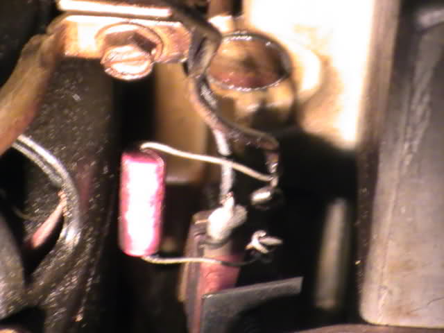

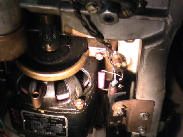

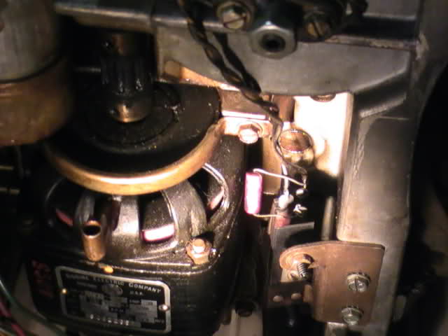

This indicates an "open" in the read out circuit. Check the detent switch and both contact block pins--the little red wires often detach, but it's odd that they both would do so at the same time--- Ron Rich

checked the wires and they are sodered on..., what else can it be ???? :(
