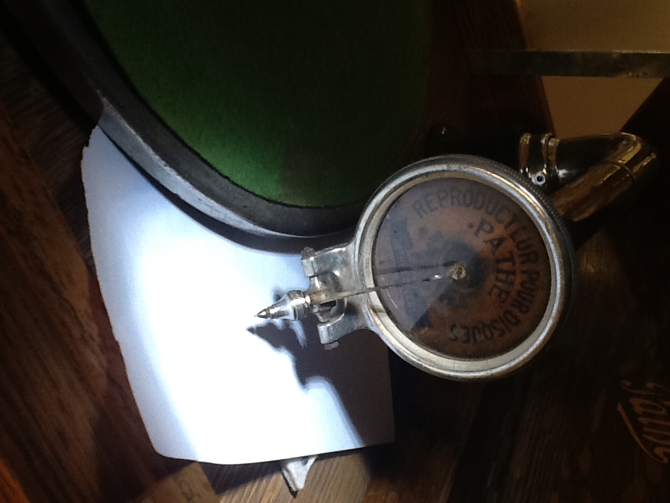

Greetings,
I am a new member of this forum. I just inherited a 1917 Pathephone Model 75 with about 10 Pathe records. In theory, it should have a sapphire ball stylus. Right? I assumed that was the case with mine until I saw a picture of this stylus on the internet, comparing it to mine. Now I'm doubting it has the sapphire ball. Attached is a picture of my stylus. The machine plays the Pathe records fine...I think, not having anything to compare it with. Any opinions or suggestions to identify what I have?
If the picture isn't clear, I can take another close up.
Thank You In Advance,
Greg
Re: Newbie...Pathe Stylus Question
by Joe_DS » Fri Jun 07, 2013 4:40 pm
I'm, by no means, an expert on Pathe' phonographs, but I know that there were a number of different styles of Pathe' stylus shanks produced over the years. Most of the ones I've seen resemble the one for sale on this page --
http://www.phonographs.org/store/produc ... cts_id=161
The tip, itself, should fit the record's groove, and have a rounded, blunt "point." That's the important part. There were diamond styli mounted on shanks used to play Edison Diamond Disc records. They were supplied for many of the off brand machines designed to play "all types of records," such as Silvertone Phonographs. The Diamond Disc styli are much smaller/finer than the Pathe' ball tips. Along this line, sapphire tipped styli were also sold for playing 78s on electric phonographs.
If you see any signs of wear, such as black powder on the tip, stop using it.

by goldpins » Sat Jun 08, 2013 2:54 am
Joe,
Thank you for the response. Your response makes sense. The picture of the sapphire ball is what I was seeing too, and I will probably buy one of these to contrast the Pathe record play.

by STEVE » Thu Jun 13, 2013 4:14 pm
Yes, as Joe says, the sapphire should have a ball shaped tip and not a sharp angled face! Beware though, there are some dodgy "new old stock" and "newly manufactured" Pathe type sapphires doing the rounds on eBay and elsewhere. These are not sapphires but GLASS and they shred your precious record grooves in seconds!

Greg:
I think that's a good idea to purchase a stylus specifically designed for use on Pathe phonographs. As Steve notes, using the wrong one can seriously damage your records. By the way, I couldn't quite tell from the photo, but it looks like there are fine cracks running through the rubber gaskets holding the mica diaphragm in place, indicating that the rubber has turned hard. If this is the case, you should replace the gaskets with a soft, fresh pair before playing too many records. In addition to reducing record wear, fresh gaskets will make a tremendous difference in the sound quality of your phonograph.
