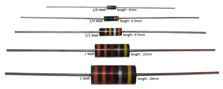

Maybe this chart will help. Keep in mind there will be physical size variations between manufacturers as there was no size standard, but it should get you in the ball park. Wire-wound resistors were often used in power supplies and voltage divider networks and are usually capable of handling more power, generally for applications requiring 5 or more watt values. Keep in mind though, that it is the value and wattage that are important, not necessarily the physical construction. If a circuit shows a 300 ohm 5 watt W.W. resistor and you have a 300 ohm 5 watt metal film resistor, you'll be fine.
In most of my recent projects, I am finding that about 75% of these old carbon composition resistors measure well over their stated tolerance value and warrant replacement. Gone are the days of just a recap.

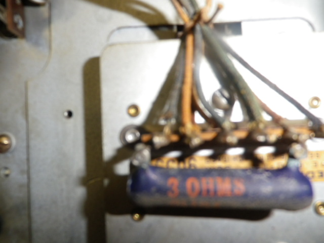

If all resistors looked like the ones in the picture that Matt shared life would be simple. This 3 Ohm resistor is about 1 3/4 inchs in length. Any way to guess what would the wattage be on this resistor?
Best
Darrell
Re: Values Not Provided
by Rob-NYC » Wed Feb 04, 2015 5:42 am
That 3-ohm will be 10 watt. It, and other wire-wound types seldom need replacement. They are either open or good.
by Ron Rich » Wed Feb 04, 2015 5:45 am
Darrell,
If on the CCU connector, it's a 4 watt resistor--Ron Rich
