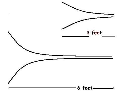

It's true that for the Consolette's horn, which is about three feet long, the taper is correct. But, that was designed to have a specific cut off frequency--about half that of the Credenza--and the size/area of the horn's mouth was factored into the equation for the overall taper in order to minimize reflection.
For an exponential type horn of say, six or seven feet in size, the taper would likely be more gradual, so for instance, at the three foot or half-way point, it may well turn out to be about 1/2 or less of the size used for the mouth of the Consolette.
Though not to scale, and perhaps a little exaggerated, this illustrates what I mean:
(What appears as a parallel bore in the thin part of the six foot horn, would, in fact, be an extremely gradual taper. My PC's image software's pixels are not fine enough to enable me to draw this accurately.)
BTW, there are actually a number of sites that list formulas, etc., concerning the designs of exponential horns with specific cutoff frequencies -- for instance --
