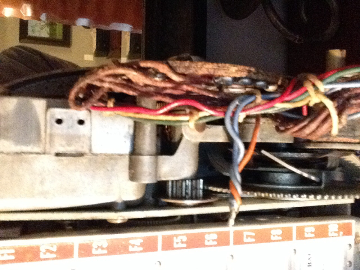

More great info. I am not sure where it came from. But there is a small wire nut on the selector wires. It looks like 1 orange wire tied to 2 blue wires. Any idea what they are for? The credit function operates normally. After dropping a nickel in, 1 credit is applied (green light goes on). After 1 play another coin must be added…
-Tony
Re: Using a Seeburg 3W1 Select-O-Matic with
by Ron Rich » Fri Feb 12, 2016 2:55 am
Cutter,
18 gauge is fine if you have only one, WOM, under 100 feet, away from the phonograph--Be sure that the screw in 3.2 amp "safety fuse" is 3.2 amps or lower--I suggest a 2 amp would be too large a size--
by Ron Rich » Fri Feb 12, 2016 3:01 am
Hi Tony,
Well, if it has been re-worked for "nickels only", I can guar-an-tee it was used in a JR or similar place !
Yep--those require that all selections be played after depositing a coin--should "say so" in large letters, below the title strips !
As for the wiring--Who knowz ?? Did you purchase the service manual for it ?? Ron Rich

by Color jockey » Fri Feb 12, 2016 5:50 am
Upon further inspection I noticed that the wires tied together are two blue wires that lead back to the letter/number key pad, they are tied to a third wire that is grounded behind the stepper selection wheel. Does anyone have a clue what this would be done for? It doesn't have free play, a nickel must be dropped into the coin slot to receive credits (make stepper motor/wheel rotate). To fill everyone in, my problem is that my new 3W1 doesn't trigger my Seeburg 100G juke box. The juke is in excellent condition and has been restored with the stepper/selector unit installed with a glowing 2050 tube. But when the 3W1 selections are made the 2050 tune doesn't seem to be triggered (no change/flicker).
Any help would be great!
Thanks again.
-Tony
by Ron Rich » Fri Feb 12, 2016 5:59 am
Tony,
Go back to Rob NYC's earlier post here which tells you how to trouble shoot this problem--
Once again--Got the Service Manual ? It contains schematics, which if read, should tell you what those wires are connected to, and thus allow someone to figure out what someone else attempted there, as it is certainly does not appear to be a factory design ?
Again--do dimes and quarters function if dropped into the coin slot ?? Ron Rich
by Ron Rich » Fri Feb 12, 2016 6:22 am
Nope--iffin it refuses dimes and quarters, it has been modified, as EVERY 3W-1 originally accepted them--The 3W-1 D, was set for "Dime play", as the lowest possible amount of money it need for 1 selection--They still accepted Nickels, but one needed to deposit two Nickels, rather then just one, in order to light the "select lamp". Original 3W-1 coin instruction glass showed "1 selection =Nickel, 2 selections =dime, 5 (or 6) selections -quarter 3W-1D glass showed 1 selection Dime, or 2 nickels, 3 selections-quarter Other pricing glass was available--Ron Rich
