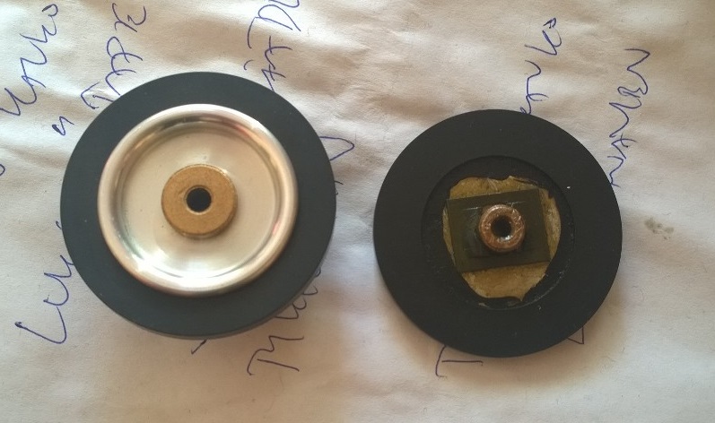

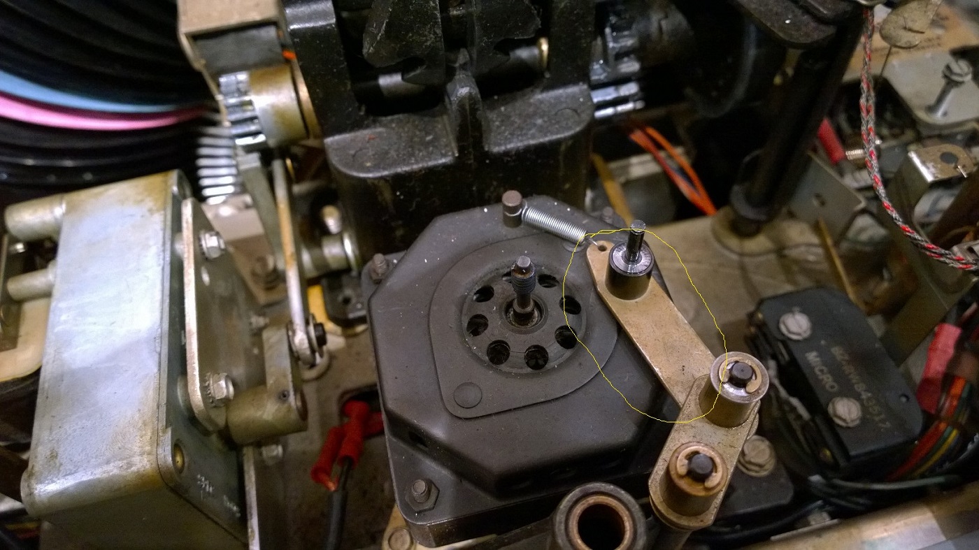

However, neither of these idler wheels seem to fit. I think someone has made
their own Link & Pin Assembly for my Continental. Have a look at the picture attached. I have also included

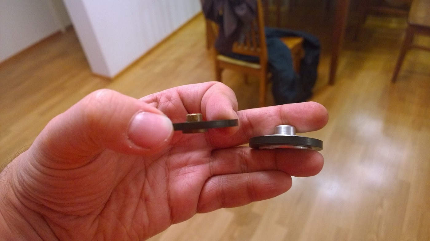

a side by side picture of the old idler wheel and the new 14.5 mm idler wheel. The 14.5 mm idler wheel is too
tall and the 4 mm hole is too loose for my link & pin assembly. The idler wheel with the 3 mm hole does not go to the
spike - it is too tight.

I have just checked out a continental mechanism the idler wheel is on a very short spindle that I estimate at being 9mm long the diameter is around 42-43mm.
My advice is to remove the clip on the idler wheel in the left of your picture (this looks similar to a 1100 or 1200 Rowe Ami idler wheel which is also the same diameter as above.
If you carefully remove the clip from the new idler wheel and do the same with your idler wheel boss you will have the correct spindle on a new wheel.

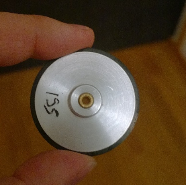

The spindle indeed seems to be 9 mm long, but the diameter is larger than 3 mm:s, but narrower than 4 mm:s. The new idler wheel with the 3 mm diameter hole does not fit onto the spike and the idler wheel with a 4 mm diameter hole is too loose, when put onto the spike.
I have attached a picture where the old idler wheel is next to the new wheel with a 4 mm diameter hole and a separate picture of the idler wheel with a 3 mm hole. If I understood this correctly, I should remove the idler wheel rubber from the idler wheel with a 4 mm diameter hole and replace the old idler wheels' rubber with that? I can try it, but I could send it to you to get refurbished. Yes, I am from Finland.

In the end the other of the new idler wheels was just fine and fitted nicely to the link & pin assembly. I had just not pressed it hard enough to its place... Thank you, problem solved and it seems that my link and pin assembly isn't custom made after all!
