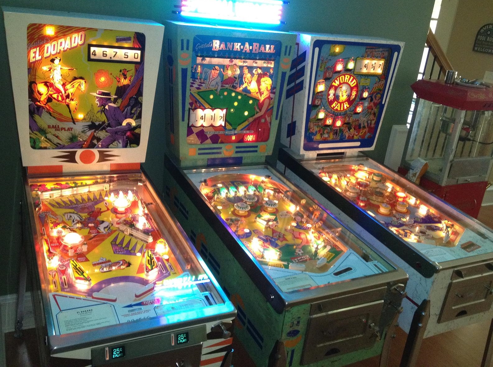

On another note, anyone interested in a top notch EM pinball in trade? I have a pretty good reputation for ground up restores on EM machines (amoung others) I have sold machines world wide, Australia England and of course the US.
Bank-A-Ball in process, cabinet needs restoration yet but mechanically done.
