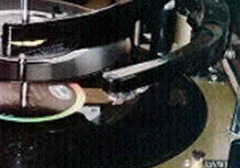

Two questions:
1. Have you released the turntable shipment locks? If not, the change cycle will repeat.
2. Are you putting the record up on the spindle? The arm feels for a record while it is up on the spindle, and then the record drops. If the spindle is empty of records, it will shut itself off. The picture shows how. The tip of the arm touches the record.

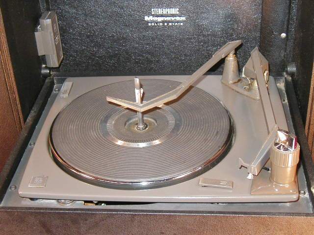

Re: On/Off/Reject Switch MODEL 1st611r
by Record-changer » Fri Jul 31, 2009 2:43 am
There are two rectangular slides located on the plinth. You can see then here:
Look at the left near the back, and at the front on the right. Slid one way, they pull the changer down for shipment. Slid the other way, they free the changer to float in its springs for use. There is an arrow showing which way to move them to lock down the turntable. Turning them a quarter turn releases the changer for removal.
