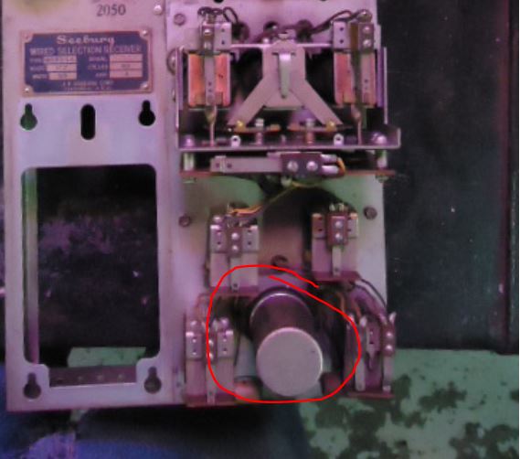

Can someone identify this item for me? I think it is a capacitor and was told by my kit maker that a small cap was the replacement. However, there are three connectors on the bottom and not two. So, something does not make sense.
Thanks, James

That is what they call an electrolytic capacitor. The values??? and the values that you havve to replace it with I don't know either.

OK, I think I have a handle on the "Big Caps". I found this write up on the net and it helped a lot.
Also, I got a WSR5-L6 schematic online and it shows that .005 MF-1000V capacitor in my WSR3 that is not on the WSR3 schematic.
My only question now is on the Mallory cap, since it has three posts with wires on it, what are the values?
Thanks all, James

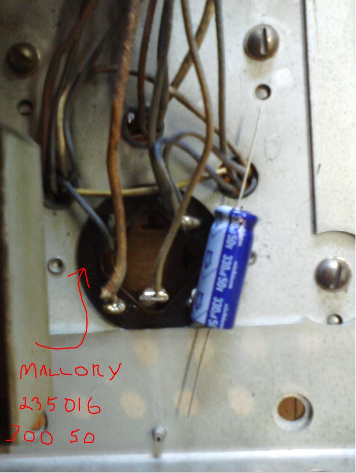

Hi Guys, Been soldering away all morning.
The Mallory is a Type WP. I think the Mallory # is 235016 as the other number 87583 is the Seeburg number. It has 300 then a space then 50 printed on it. Would this be 300uf and 50V or 50uf and 300V?
Attached is the cap that came with the kit. Is there any reason to run down one of the cans from Antique Electric or just use what was supplied in the kit? I attached a photo of the replacement. Since I have not taken it out yet what is the procedure for wiring it in?
The kit has the small cap and as you can see there are several leads going to THREE posts on the Mallory.
Slogging through it...
James
Re: M100A Mallory Type WP ???
by Ron Rich » Sun Oct 13, 2013 11:39 pm
James,
There are only TWO, ELECTRICAL connections there. The "can" connections are all common. The center is the positive one. 300ufx50volts-- Ron Rich
by James_Douglas » Mon Oct 14, 2013 5:24 pm
Thanks Ron!
Any performance reason to hunt down an original large Mallory type can? If not, then I will pull it and stick in the replacement and figure out a way to isolate the leads so nothing shorts.
Thanks again, James
PS. Now that I have sipped some coffee and am waking up...I can leave the Bakelite board in place when I take the Mallory out and jump the 2 common wires and then add the new capacitor between the center wire and the jumper. Correct?

by Ron Rich » Mon Oct 14, 2013 5:28 pm
James,
You probably won't find a can like that--but there is no reason to hunt one down--

by James_Douglas » Mon Oct 14, 2013 6:18 pm
Rob-NYC wrote:James, (and anyone else dealing with these machines) Seeburg used a negative voltage with respect to chassis so it is important to keep the can of the new cap insulated. For these low voltages a little tape around the can is enough.
Rob.
Rob, Thanks for the heads up on that. I did not know that. I will go back and wrap all the capacitor cans with some tape. Thanks again, James
by Ron Rich » Mon Oct 14, 2013 11:56 pm
Guy's,
That cap is grounded to the can--no tape needed--the one that is not grounded is the 300uf (330) in the stepper section. Ron Rich
