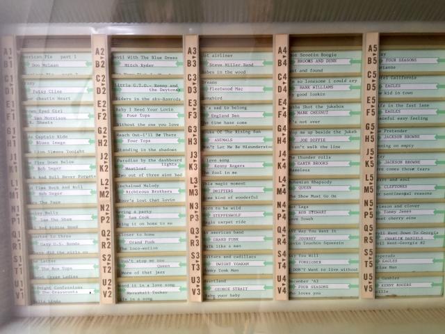

These machines suffer from faded lower graphics and record card inserts.
This was mine before I bought it.
The graphic was in a real sorry state.
I managed to get a "new old stock" record card insert from Victory Glass, but I think it was one of the last ones they had. I photo-copied it, so if you buy the jukebox and yours needs replacing, I can e-mail you a copy.
I remade the lower graphic for a few pounds with over-laid bits of A4 coloured acetate, plus one layer of frosted acetate to obscure the back panel. But I believe Stamann do a replacement graphic if one is needed.

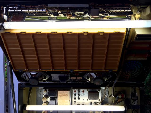

The front panel can be hinged down without disconnecting anything. There should be a chain attached to restrict the movement to about six inches. This gives an unrestricted view and access to the scan switch and enables an operator to reset the popularity meter.
Make sure the chain is attached, or the whole front panel will fall as it is only secured at the bottom by the lugs that sit in the frame.
With the top swung up and latched and the front panel in this part-way down position, it is usually enough to have a good look round inside it.
The black plastic grill shown in my photograph of the original graphic, has clips which enable it to be completely removed, to gain access to the lower fluorescent tube.

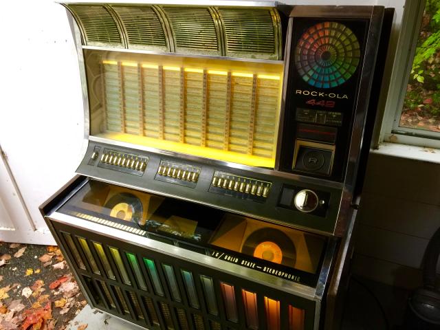

So it's official.. I'm the proud owner of this Rock-Ola 442!! Made the deal for $300 even!

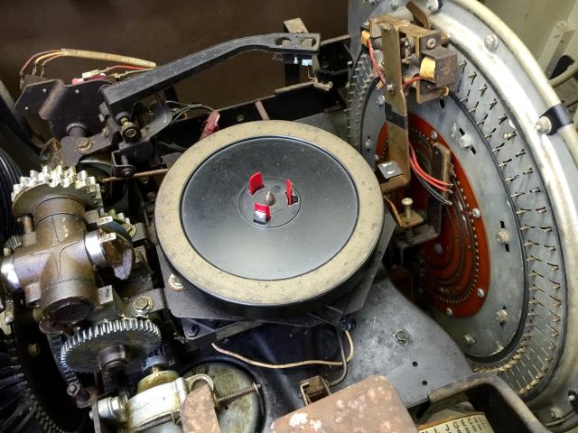

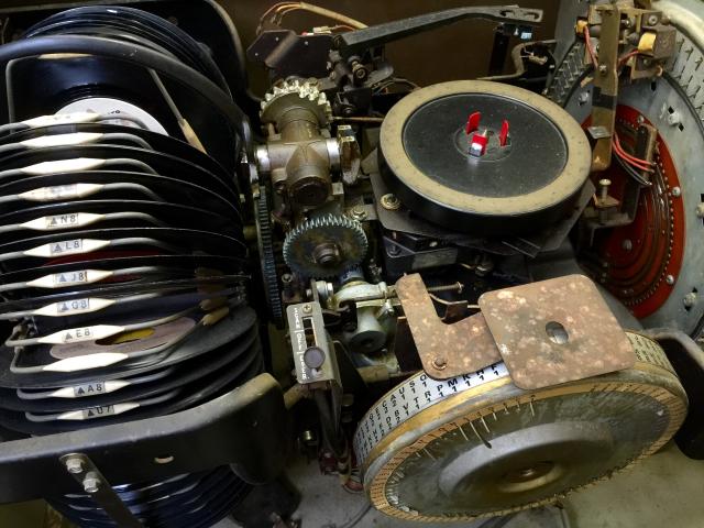

Now, the fun part.. I plugged her in and took as many pictures as I could. When I flicked on the main power switch to my surprise all the lights came on immediately, even the fluorescents. At this point there was also no audible noise from the speakers at all (read on). Please take a look at the pictures and consider the things I'm about to mention and give me all the input you can! I'm picking it up next Saturday afternoon so plenty of time to ponder haha.. Here are the few things that I noticed right off the bat:

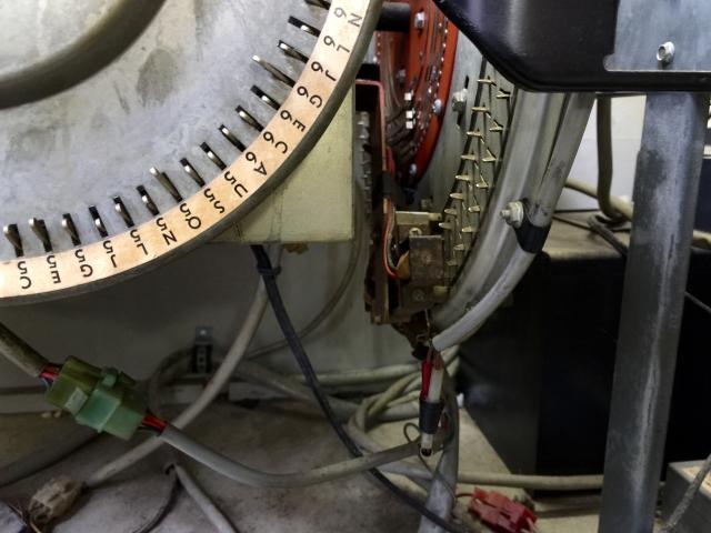

1) The main "alignment" problem she was talking about was this.. When you first make a selection, a relay clicks and the large, armature type wheel on the right side with all the contacts (what looks like a super sized variable AC transformer) starts to spin, but the carousel that holds all the records does not. I'm assuming they are both supposed to be spinning together. Because of this the wheel on the right spins about 3 full turns before the relay releases and the unit stops. I'm guessing since the carousel with the records is not spinning it is endlessly searching for the selection and just times out in the process?? Because of this nothing else happens, no arm movement or anything from the turntable. I didn't try anything else in fear of damaging something more. Obviously couldn't test audio yet either.

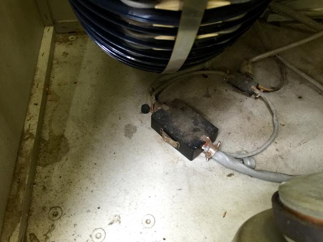

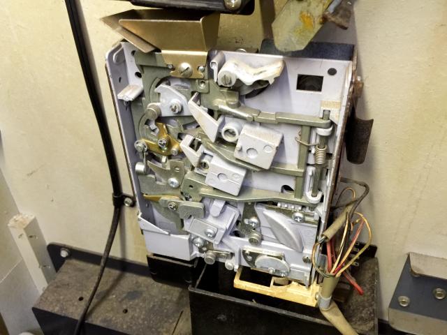

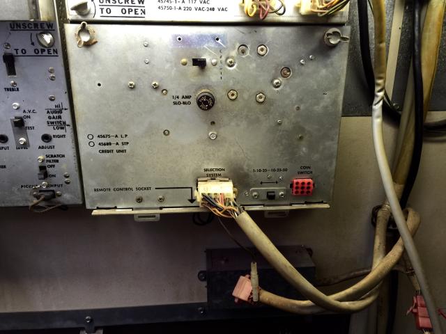

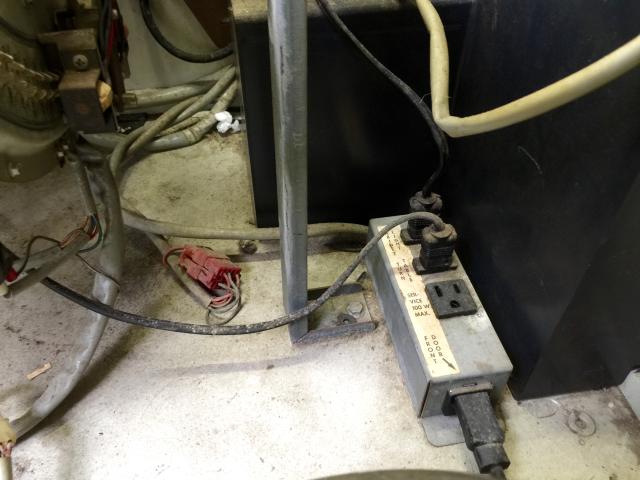

2) The coin mechanism appears to my untrained eye to be completely in tact and clean (see pic). However, as you can see in the pictures they unplugged the coin mechanism from the main board which in turn allows selections to be made with no money inserted? I would like to make the coin mechanism active again like it was originally.

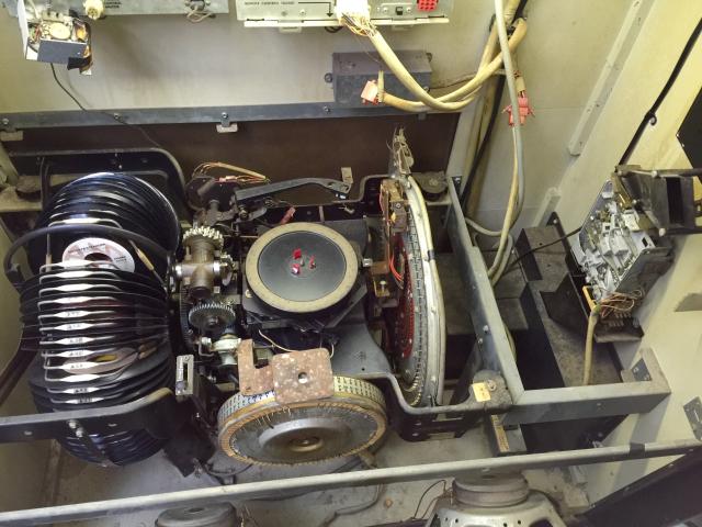

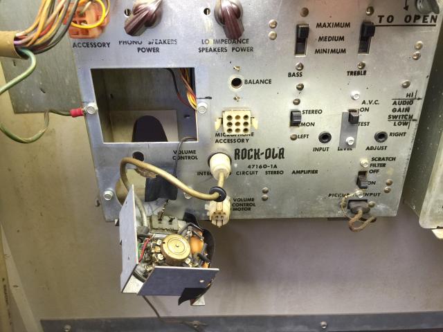

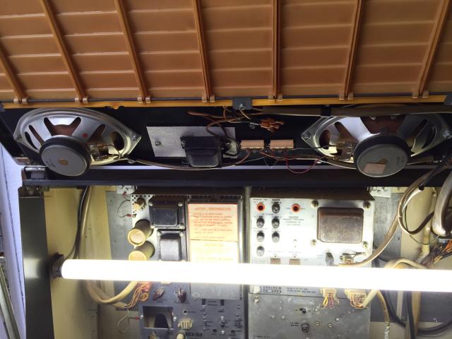

3) Over on the left board which seems to be dedicated to audio processing as you can see in the picture there is a hole in the metal case and a piece of electronics hanging out of that hole by the wires which looks like it's supposed to be mounted in that spot. One of the two single small wires its hanging from where the electrical tape is wrapped is disconnected from the push on terminal that seems to be its mate. The other interesting thing is because this piece in question is hanging by the wires I naturally grabbed it to look at it and as soon as I moved it enough that the metal shell it's in lost contact with the metal shell on the main board it's hanging from a loud 60 cycle hum began emitting from the speakers. As soon as I let it hang against the main board again from its own weight the hum was gone. Assuming since it's probably supposed to be mounted in place in that spot it's just a normal grounding issue, just thought I would share.

My advise--Purchase the service manual package from one of the suppliers listed above--then--
READ it !
Before you move the phono, remove all of the records that you can--Remove the turntable, and tape down the tone arm.
Also, look for any/all "loose items", remove or secure them !
To your numbered points--
1. Once you have read the Service Manual, you will know what items are called, and can ask questions, using terms we can all understand--as of now, I don't know if you are speaking of the write in arm, or the read out arm, here ??
2. Its a National brand, NDQ,HD, or D, unit--it may or may not work--probably needs a bath ! The fact that it's un-plugged has nothing to do with "free play", but yes, it needs to be plugged in for coin play.
3. Yes--audio processing unit--commonly called the Amplifier, or Amp. The "thing hanging", is the "local" or remote volume control--can't tell which.
