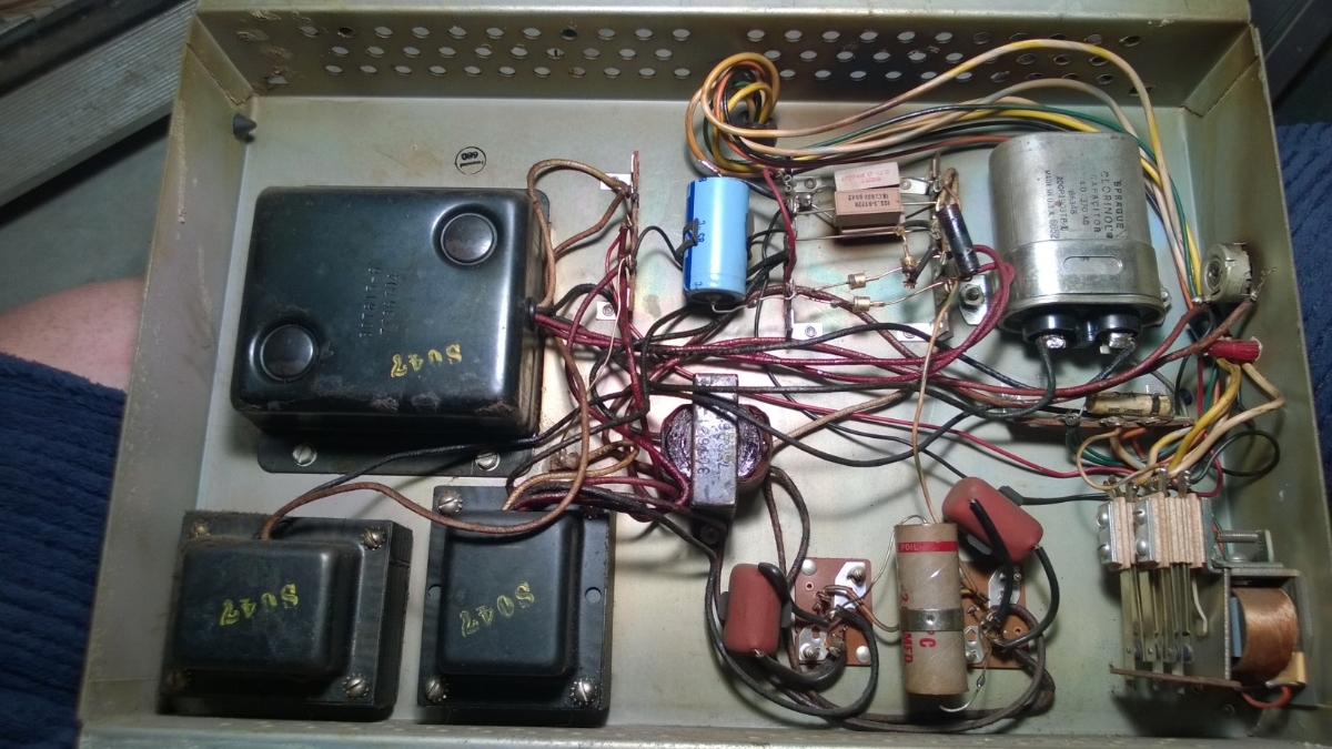

Hi Ron,
I received the two caps you sent me - thank you. I also received your mech guide. Good stuff!
I know where the large cap goes but the smaller 1200 MFD cap you sent is stumping me. In the photo, the upper blue cap is 3300MFD and the lower paper cap is 2 MFD.
Which one am I meant to replace?

Posts: 8195
Re: Bought my first Jukebox! Seeburg SS160.
by Ron Rich » Thu Apr 30, 2015 4:54 am
Hi Jack,
Someone replaced the 1200 with the 3300 ??

Hi Ron,
I'm assuming from your comment that the 1200 you sent is to the replace the blue upper one and someone in the past didn't know what they were doing.
I thought it looked too new to be in there. The solder joints are different also...
OK, that gives me direction now. I'll update after the cap replacements.

Posts: 8195
by Ron Rich » Thu Apr 30, 2015 5:23 pm
Hi Jack,
In that type of a circuit--as long as it is large enough, it should work---I would assume, whomever change that cap, did not have a 1200 available, and just used stock at hand---Hint: Insulate that cap holding clip, as that circuit operates "above ground", and the insulation on the new 1200 cap is rather thin--. Ron Rich
by Rob-NYC » Thu Apr 30, 2015 6:52 pm
One caveat in situations like this is to avoid using a filter cap that is that far over the original rating in capacitance. For test where you can keep an eye on things it's OK, but don't send it out that way.
My reasons are:
The inrush current is a lot stronger with the larger cap and those old top-hat diodes are not really suited to dealing with that, especially in a frequently switched applications.
If a diode shorts it puts AC on that cap. It will likely short and "pop" and due to Seeburg's "frugal fusing" philosophy take out the power tran with it. I've seen this scenario.
I add a 1 amp-slo fuse to the primary circuit.
Posts: 8195
by Ron Rich » Fri May 01, 2015 1:22 am
Hi Rob,
I think you may have a point on the inrush current--
However, I would guestimate that I have "serviced" over 5 thousand ( maybe 10k ?), 45TASU's in the last almost 50 years, and I know I can count the number of bad transformers on one hand, using one finger !
FYI--On "fusing"--Seeburg had a problem with UL recognition of their products and to resolve it, agreed that they would submit all new product designs, starting with the LPC-1 model, to UL for approval, and allow UL to dictate, exactly, which type/style/size fuses would be used where. Ron Rich
