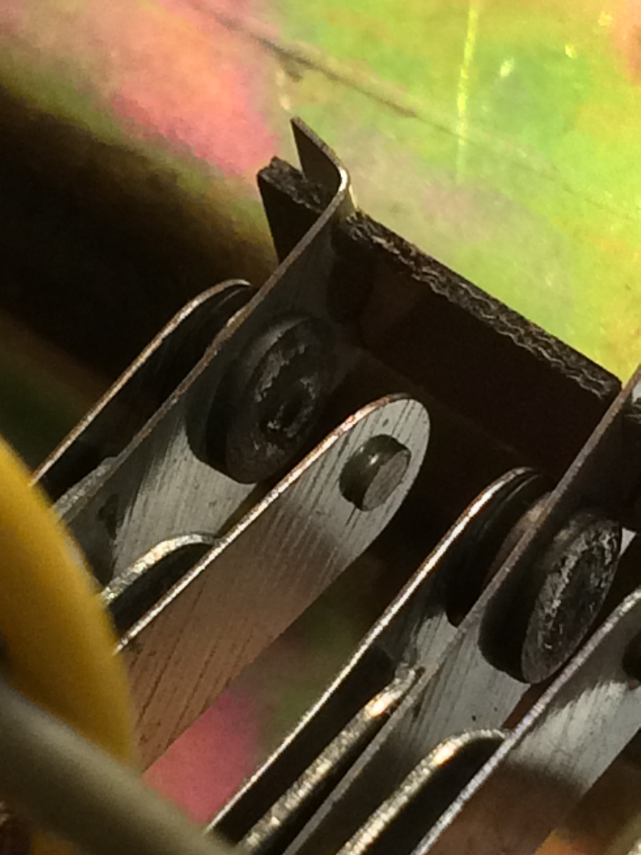

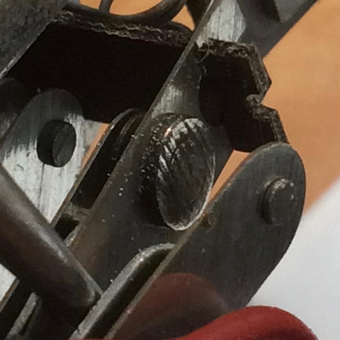

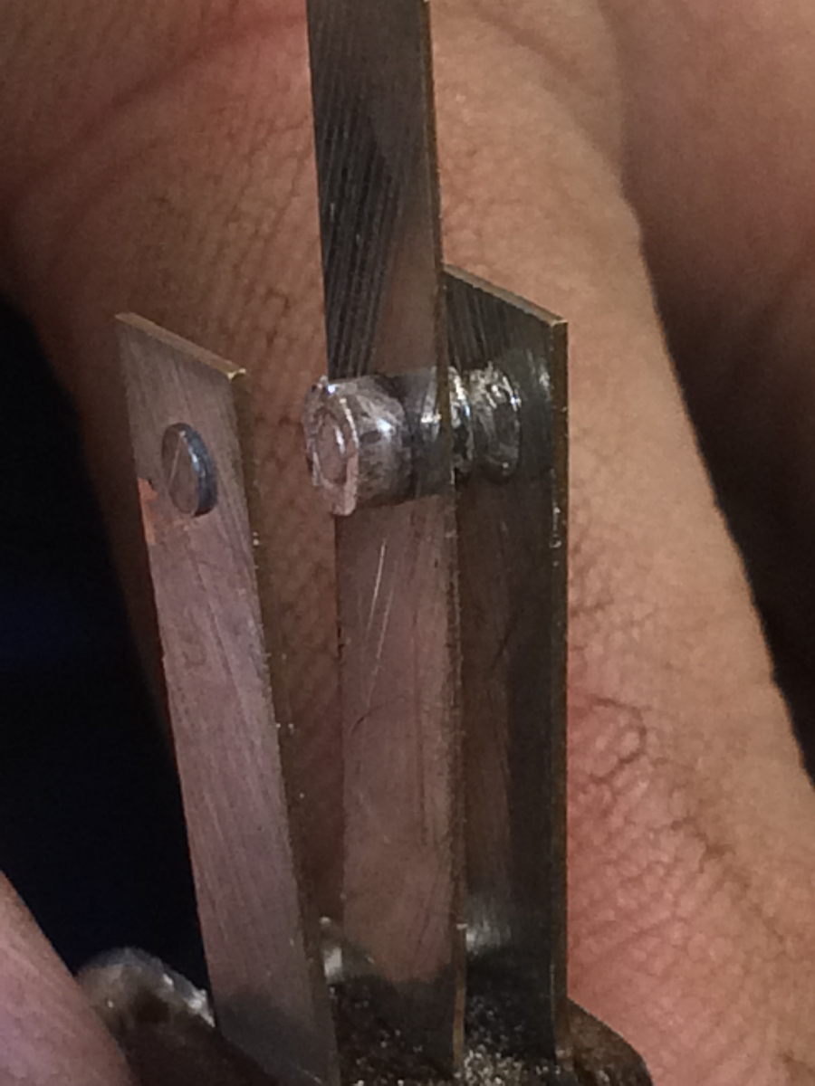

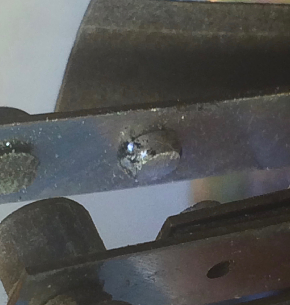

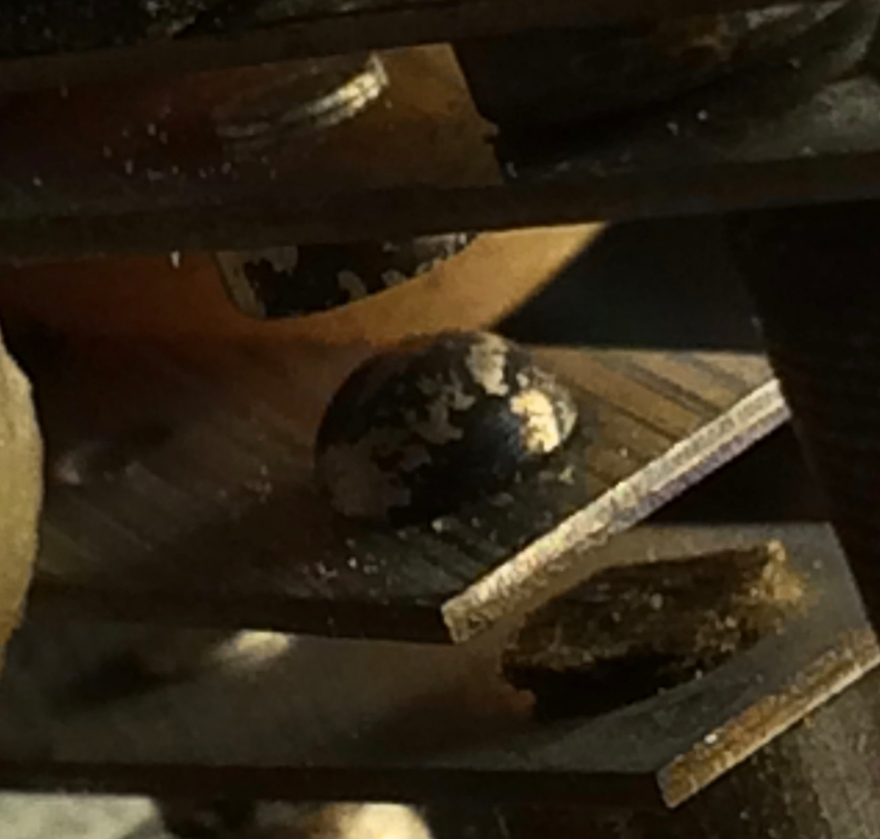

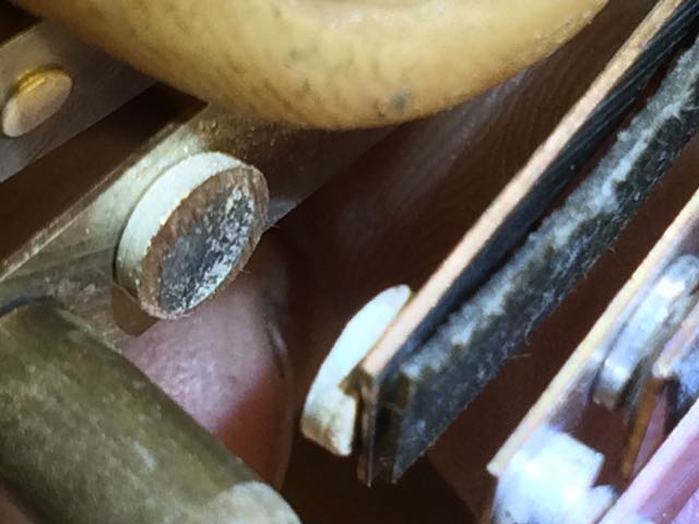

Should I burnish the contacts as part of the "tune up," or only if there's some evidence of a faulty connection?
Some of the contacts as button-shaped, some dome-like. What's the reason? Should they be treated any differently?
I'm trying to find the Goldilocks spot-- where I do enough to correct/ prevent problem but not so much as to create an additional one.
For the images below, I'd welcome a "diagnosis," including if the contact appears overburnished?

Re: "Contact points"- care/cleaning
by Ron Rich » Sun Mar 06, 2016 5:27 pm
My rule for myself is: Don't fix nothin' whutz not broke ! Therefore I do not recommend that one burnish every contact. Just as in filing, unless there appears to be damage on the contact point, I do nothing to it (other then clean it) . If deeply "pitted" / "burned" the pit/burn must be removed, usually with a file, then "dressed" with a burnishing tool, then the blades must be re-adjusted.
As for the contact's shape--ain't nothing one can do to salvage that, other then replace the contact--which is the primary reason for my rule ! Ron Rich

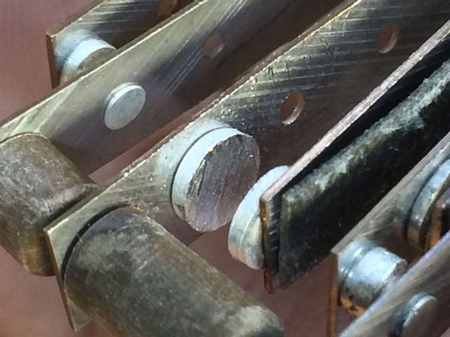

Some very close up contacts with questions.
by NYJB » Mon Mar 07, 2016 1:12 am
Before. Strange coloring. Why?
before. strange coloring..jpg (42.31 KiB) Viewed 849 times
After: smooth enough? ruined?
is this what you mean by pitted? or is it just dirty?
ruined by burnishing? rough burnishing job?
spray this then leave it alone, yes?
round black.jpg (33.42 KiB) Viewed 849 times
any idea why this had these grooves?
grooves and circle.jpg (42.4 KiB) Viewed 849 times
is there any significance to the circles?
another circle.jpg (32.12 KiB) Viewed 849 times
