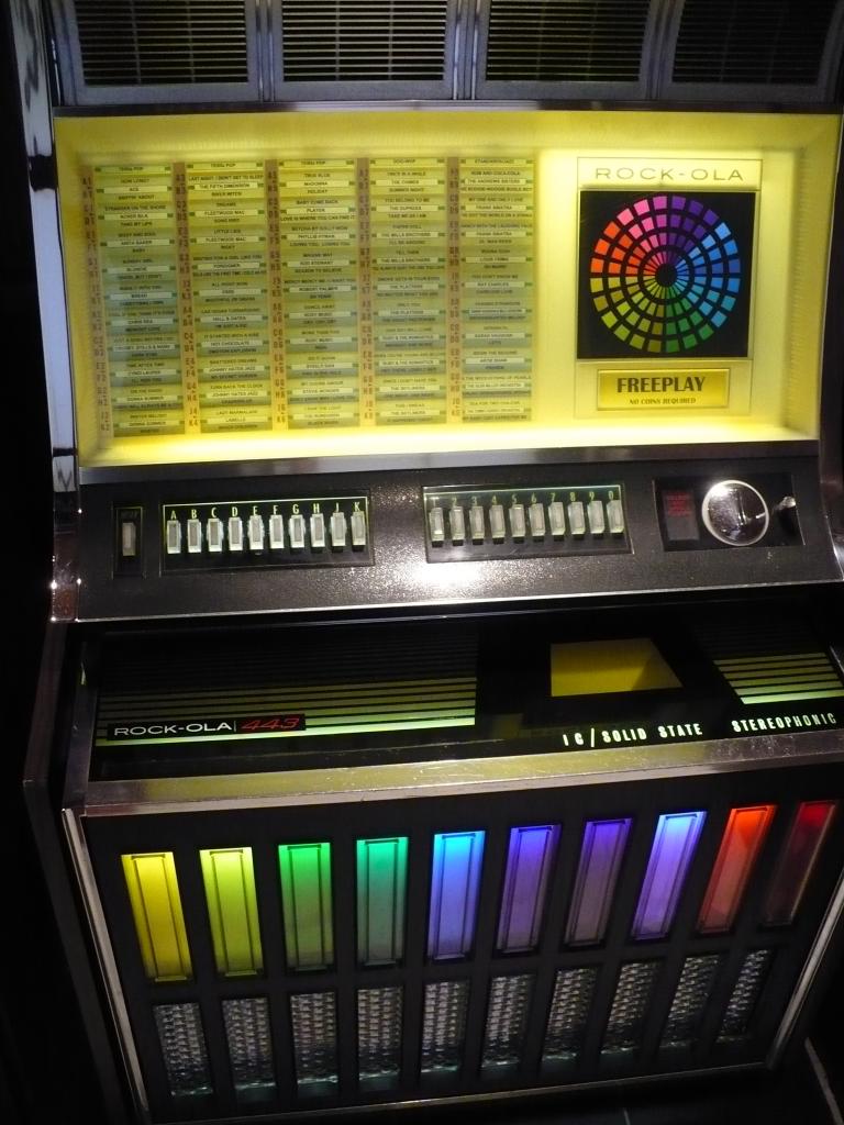

I've used theatrical gels from eBay to replace the coloured strips on my Rock-Ola 443.

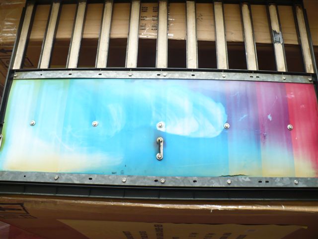

The original which was all one sheet always go "blue," over time.

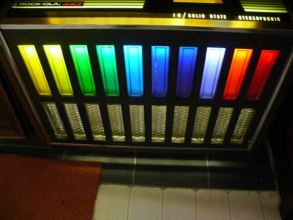

After a bit of experimentation, overlaying different coloured gels and a clear defused sheet, I got pretty much the desired affect.
This was the state of it before I bought it.
The graphic had deteriorated to this.
This was my final attempt, the third panel from the right (you can only see it in the Photobucket file) isn't actually as you see it, it has more red in it, but my camera doesn't pick this up.

These images are in a Photobucket file, if you click on any you can see the full-size images in that file.
