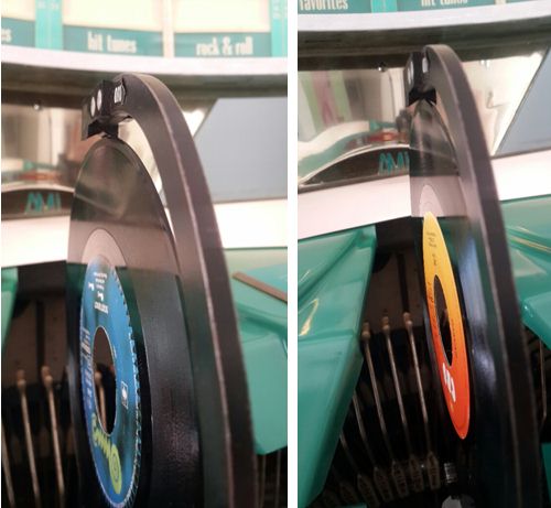

can you explain to me how normal is that:
see pics
one record is good size and will get 100% grip (thanks to your advice), the other will be 'dancing' in the gripper and in risk of loosing it when the gripper travels (yes it drops it). This is the same position i just switched the records.
I guess some vinyl manufacturers have produces smaller/bigger 7" records ??
but how does the Ami mechanism is handling this
does this mean not all records will suit my machine ?
Eitan

by Rob-NYC » Mon Feb 29, 2016 6:13 pm
Eitan, unless they are making 45's a lot smaller in the Middle East the problem you are having is that the gripper is still not fully extending.
With no record and the gripper standing vertical, try pulling up on the lower "jaw" of the gripper by grabbing the collar out of which the two arms emerge. Do not use too much force but enough to make it fully emerge. These cases of old oil turning to sludge can be very persistent. The stuff gets like cement after being caked with dirt and left to sit and harden for years.

by Ron Rich » Mon Feb 29, 2016 9:29 pm
Eitan, Rob,
The spec. for a 45/33 "7 inch" record is 6-7/8" plus/minus 1/32" nd.
Anything outside that spec. should not play--

(the records in the pics are both european)

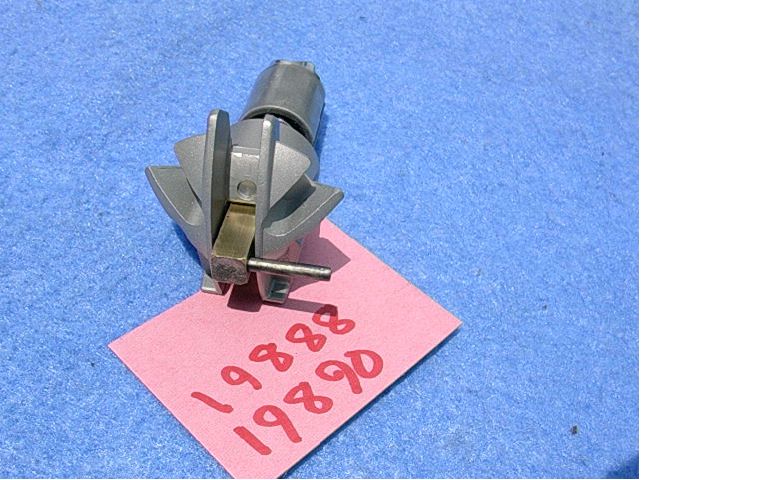

the spirol pin holds the back part (weight) and the collar pipe, so one can not dismantle the gripper without pulling this pin - see pic (not my Conti but same idea)

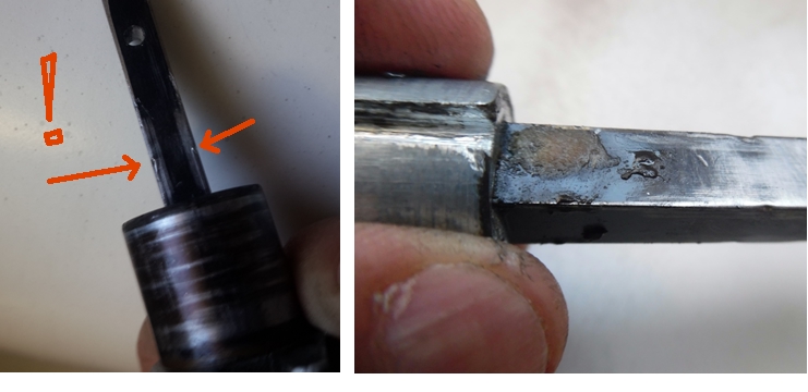

I have solved it
i pulled back the spirol pin, this was very hard job, hammer etc...
Well this machine was abused by someone probably using a screwdriver trying to draw back the gripper weight.
look at the small chips the blade caused (in red), i had to sandpaper those, when i held it in hand outside you can feel them stopping the collar movement.
This pin was not an easy task though, but it's of course worth it and a great triumph (now i have to get it back...).
also look at the old grease residue inside, it was a pleasure cleaning it.
