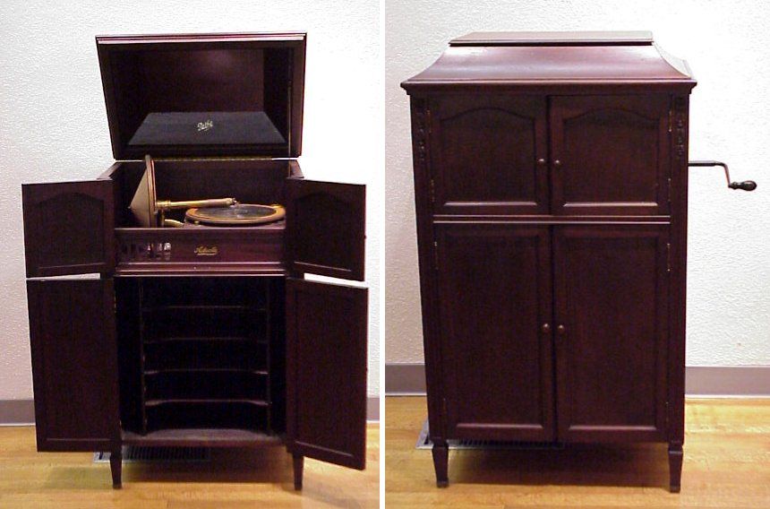

I agree that Pathe did, indeed, manufacture some "oddball" phonographs. My favorite is the large cabinet model equipped with the paper/fiber cone "speaker." I listened to one several years ago in the home of a Sacramento area collector, and was very impressed by the overall sound quality. Not as forceful as a horn gramophone, but still very rich.
Re: Pathe Actuelle Phonograph
by Joe_DS » Tue Feb 27, 2007 2:54 am
I was finally able to hunt down an online photo of this machine, for those who may be interested. Sorry if it's a little dark --
Pathe' Actuelle Phonograph
The original image can be found at --
http://www.burchardgalleries.com/auctio ... 0/l032.jpg
FROM -- http://www.burchardgalleries.com/auctio ... n2300r.htm
