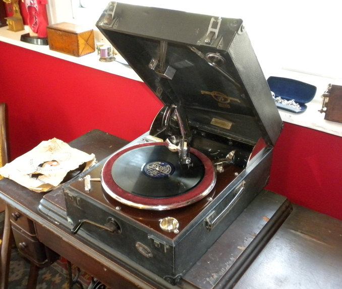

Hello folks. I joined a few months ago and posted about my columbia grafonola 112a. I had been busy moving house and not looked at it again til now. I know it'll need a little service by a gramophone engineer but I was hoping you might be able to give me an idea of what might be amiss. I've read this fellow's website
http://www.gramophones.info/graminformation.html#Q000
so I know its brake needs looking at as it stops too quickly and I need some new needles for it. The wind actually is perfect- initially I had not wound it up enough! It lasts for well over the length of the 78.
Its main problem is that when I move the tone arm over the disc to play it it feels not tight enough and the soundbox is loose- it has fell off a few tiimes! I presume a screw might have got lost. It is a fiddle to play the disc- getting the arm and soundbox at the right angle to play- I didn't have this prob before.
However it plays fine if I start it at the left side of the disc and not the right!
I know I ought to get new needles for it as the needles are the ones I got when I was given the gramophone. I am ordering it some soon.
So was wondering why it plays better left- surely it isn't meant to be played at the left side? Yet it seems to want to go there... :lol:
Its loose arm and soundbox- are they easily sorted out?
By the way I am as technical as a jam sandwich so won't be able to do the jobs myself.

by Joe_DS » Mon Dec 31, 2012 8:20 pm
This should be the proper playing position for the tonearm --
(Not mine, unfortunately.)
The record's surface should pull away from the needle's tip. If the sound box is positioned on the other side of the spindle, the needle will point inward toward the groove, and gouge it out.
The sound box, of course, should be firmly attached to the end of the tonearm, and there should be no air leaks, or looseness, in the connection. I would guess that the rubber gasket used in the joint is either missing or has hardened and should be replaced. (If I remember right, this type of sound box twists and locks in place.) Along this line, the gaskets that hold the fragile aluminum diaphragm in place could probably also stand replacement, and the needle bar's pivot should be readjusted for maximum compliance without shake or rattle. I'd say that the tonearm & sound box could probably stand a good overhaul by someone who knows how to do it properly. There are a number of shops that specialize in this, in the UK, and contacting some of them would be your best bet. Ian Calderbank, I understand, is very helpful, and as he notes on his site, you can contact him via his email jump for referrals.

by MsVintage » Mon Dec 31, 2012 9:44 pm
Thanks Joe! I have got it in this position and it's playing right now as I type. You know what the problem was? Its arm is a little loose as I said, and had fallen back a bit, so as a result its soundbox kept slipping off the disc.
Yes it does twist and lock- it feels ok rtight now but comes off very easily if you need to take it off, and when lifting the arm onto the disc it can fall off if one is too quick or not gentle.I will look into getting it a new rubber gasket.
Yes Joe- I think you are right- its tone arm and soundbox need some tlc by a competent gramophone repairman! Ian is away til the end of Jan so will email him after that, but I can also ask the man at my local antiques shop- I have been meaning to ask him for ages! He has had gramophones in his shop so maybe he knows about them. Anyway as I only work 12 hours a week no rush because I will have to save up for Gramophone's repairs!
