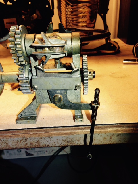

Hello all and thanks for reading my post. I recently obtained a Rock-ola 450 not working. After messing around with it trying to figure out I came to a educated guess of what was wrong. I removed the motor that was humming right before the protection circuit kicked in. when i did the motor started to work. My initial thought was something was binding. I removed the unit and set it on the work bench. I have narrowed it down to this part. It doesn't want to go through the record picking up part at all. I can see where it should move but it seems something is sticking and me being new at this I can't see what is the issue. I am decent at repairing things with guidance in this area. Thank you all for any help you can give!

The gripper assembly is seized up as a result of solidified grease so nothing will move until the old grease is removed and the assembly cleaned and lubricated. The gripper and basket motor most likely would need cleaning and lubrication and as well as other moving parts. Re gripper assembly some say using a hairdryer to heat it up is handy to remove old grease or you might get away with saturating it in oil for a few days, but the proper way would be to strip, clean and relubricate. if the assembly can't move this will pop the mechanism breaker and possibly blow a couple of fuses

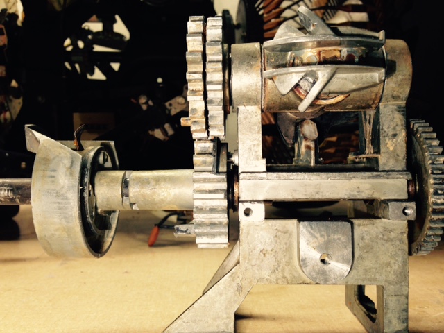

What part seizez up? It all seems to move but the gears don't seem to line up properly. If you look close at the pictures you can see. Is it possible the gears moved on the shaft maybe from the previous owner trying to free it with a large pair of vise grips? I see brass bushing s at the ends and one seems to be sticking out slightly. Is this normal?

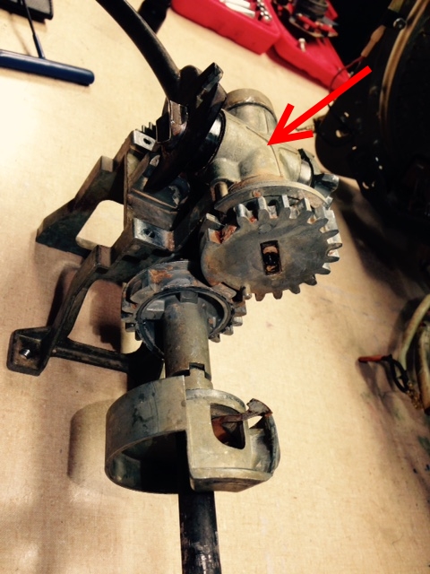

My Rockola 460 had the same problem. The gripper arm was frozen solid. No amount of wiggling would break it loose. Using one of your original pictures, if you apply some heat with a heat gun(hair dryer probably doesn't get hot enough and a torch might be too hot) in the area marked by the red arrow and then spritz a little solvent like PB Blaster(not WD40) on the sliding area, I think you'll get that part to start moving again. Once it's freed up, the rest of the stuff should be able to move and you can go back and lube it all up with TIOMO(see the lube sticky).

I let it soak in oil over night and it freed up. I put everything back together and used the scan switch to see if it would work properly. For some reason it seems something may not be lined up and is binding. Is there a specific way to align things? I'm guessing there is. The record picker part is landing on the toner arm side which doesn't seem right.
