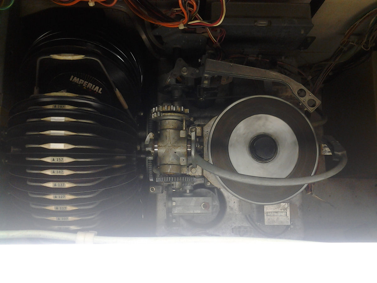

Tried the cancel switch doesnt seem to be triggering anything at the base of the tonearm. While in Operate mode the platter keeps spinng. Gripper arm is directly over the turntable (see attached photo).
Tried pushing the gripper arm motor both ways from the gripper arm but didnt want to force it too much, it seems pretty locked where it is. Is there a manual crank/override for it somewhere perhaps?

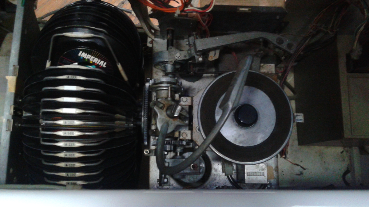

Ok so I found the little shaft and rotate it but it locks up at the point pictured below, not quite over the record bin.
I tried turning it on again and it just returned to the table and wouldnt function.
Should I get a pliers and force it to turn more?

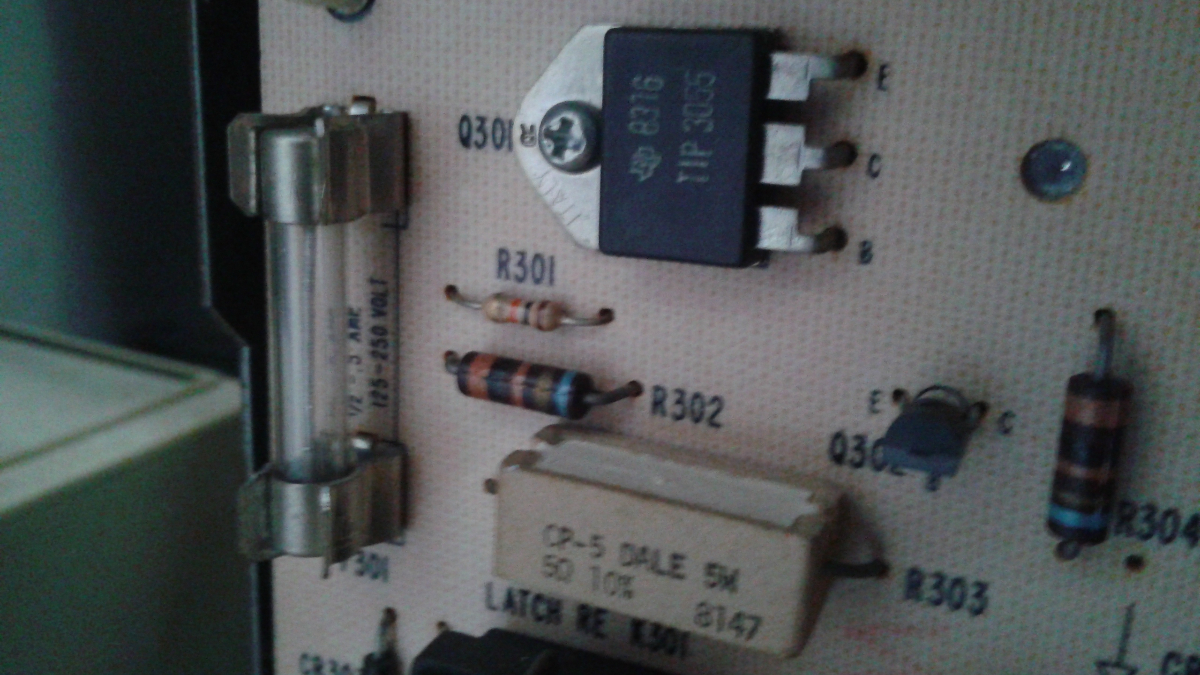

Fuse in back seems ok too, as do the fuses on the main control board.

Loosen the gripper motor that will make it easier to move the gripper arm manually, the motor is held on with three hex bolts and try and return the gripper arm back over the record basket, it should move fairly easily if not something is causing it to bind

You need to turn the motor shaft until the gripper arm completes it's cycle and stops over the record basket. If you do not do this it will continue to attempt to play a record. You need to ascertain what is stopping it at the point before it reaches the basket to park?

I can see it go towards the record bin while I turn it but it doesn't make it over all the way. If I turn opposite it just goes back to the platter.
Will try some grease on it and see if that unsticks it.
