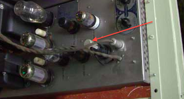

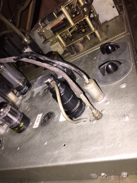

re: Grid Cap...I am a complete novice at tubes, so I very sorry what I am sure are such basic questions. I may be using the wrong terminology. Perhaps I should be asking about a "shield/cover"???
The tech who serviced my amp said this may help reduce the hum from the amp before the record plays.
here is mine
and here is I guess what I am missing (picture from jukebox-world.de)?
If so, do I need to look out for one from a parts machine (as I cannot see anything in the usual repro parts sellers)
thanks!

You don't need that part.

Looks and sounds good, happy you got it going :D
Not sure if you need 6j7 grid cap however if you want one there is a seller on eBay that has a NOS with grid cap

I have seen a "million" or so that do not have it-never heard "hum"--Hum usually indicates a need to re-build it correctly !
