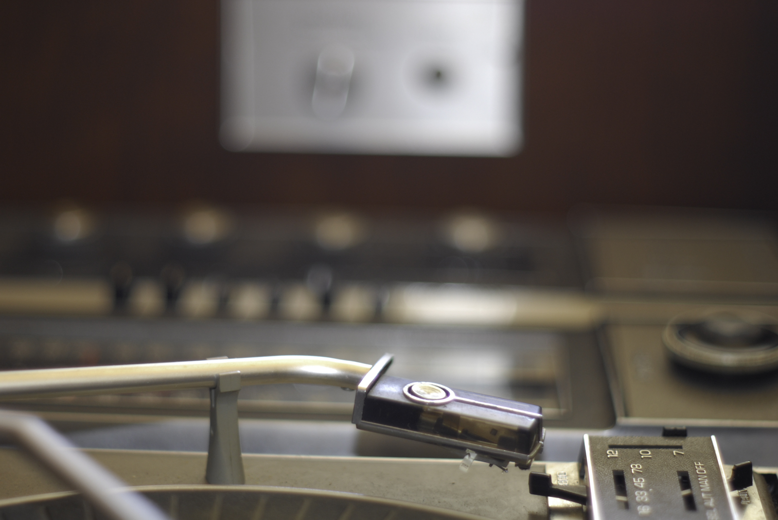

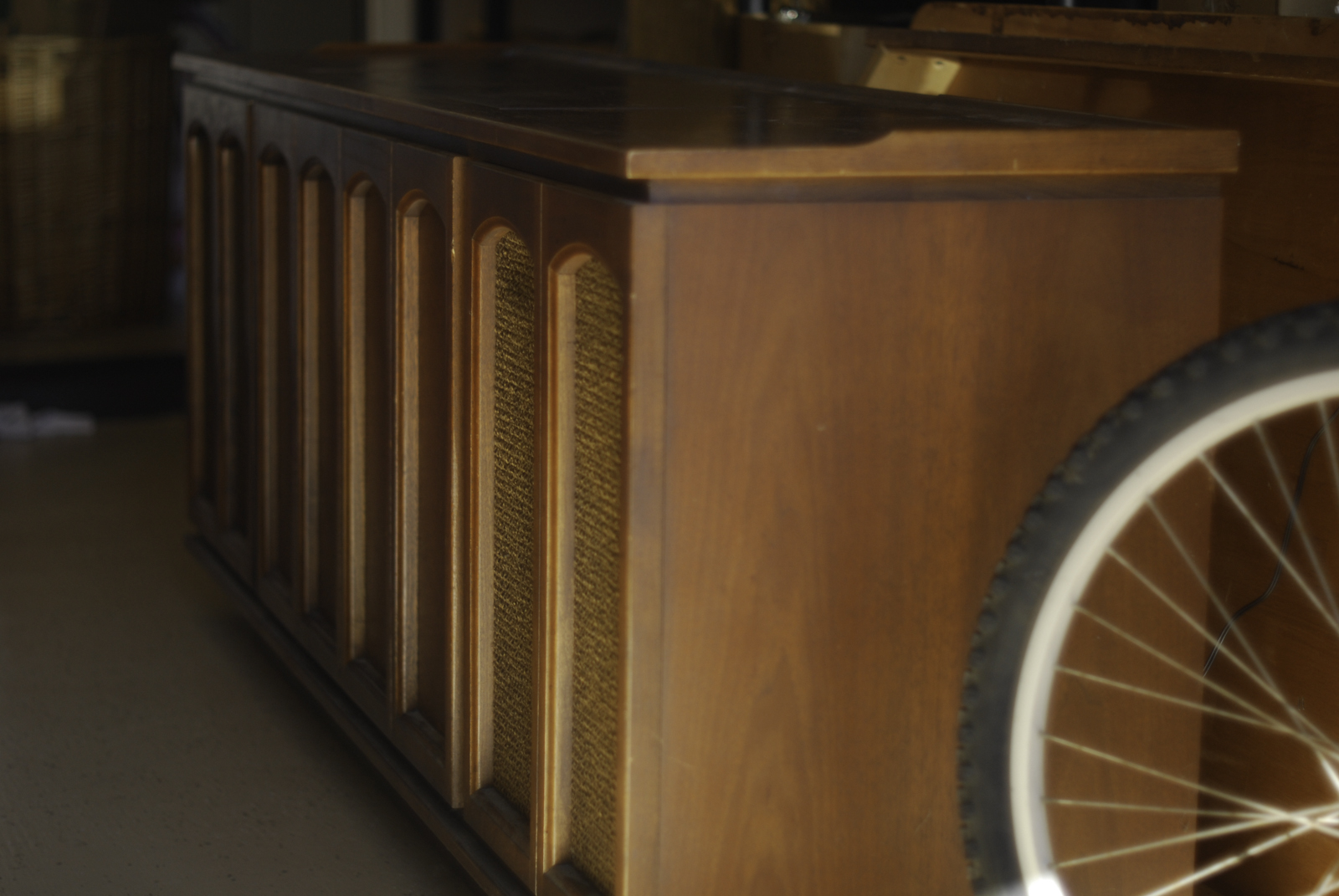

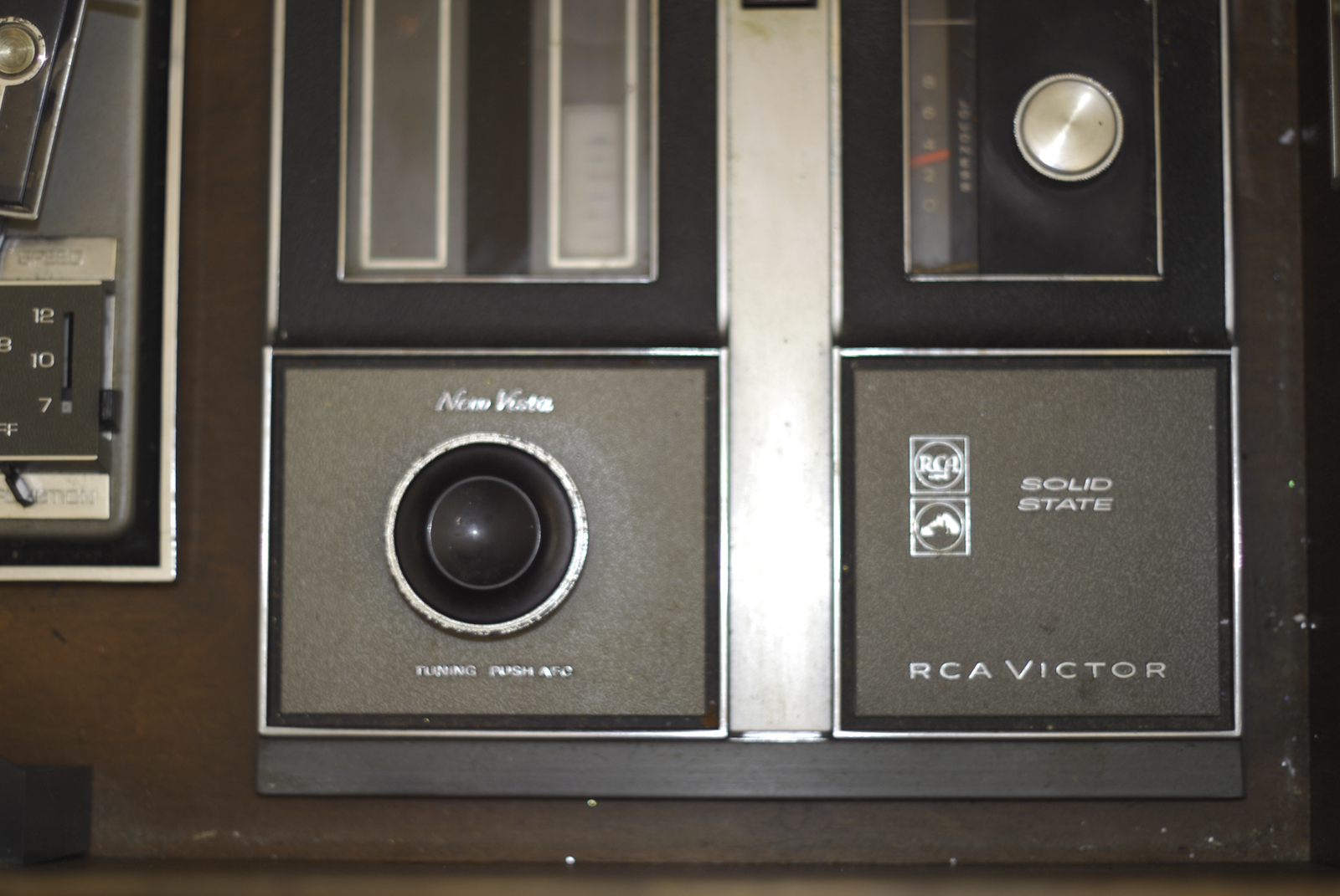

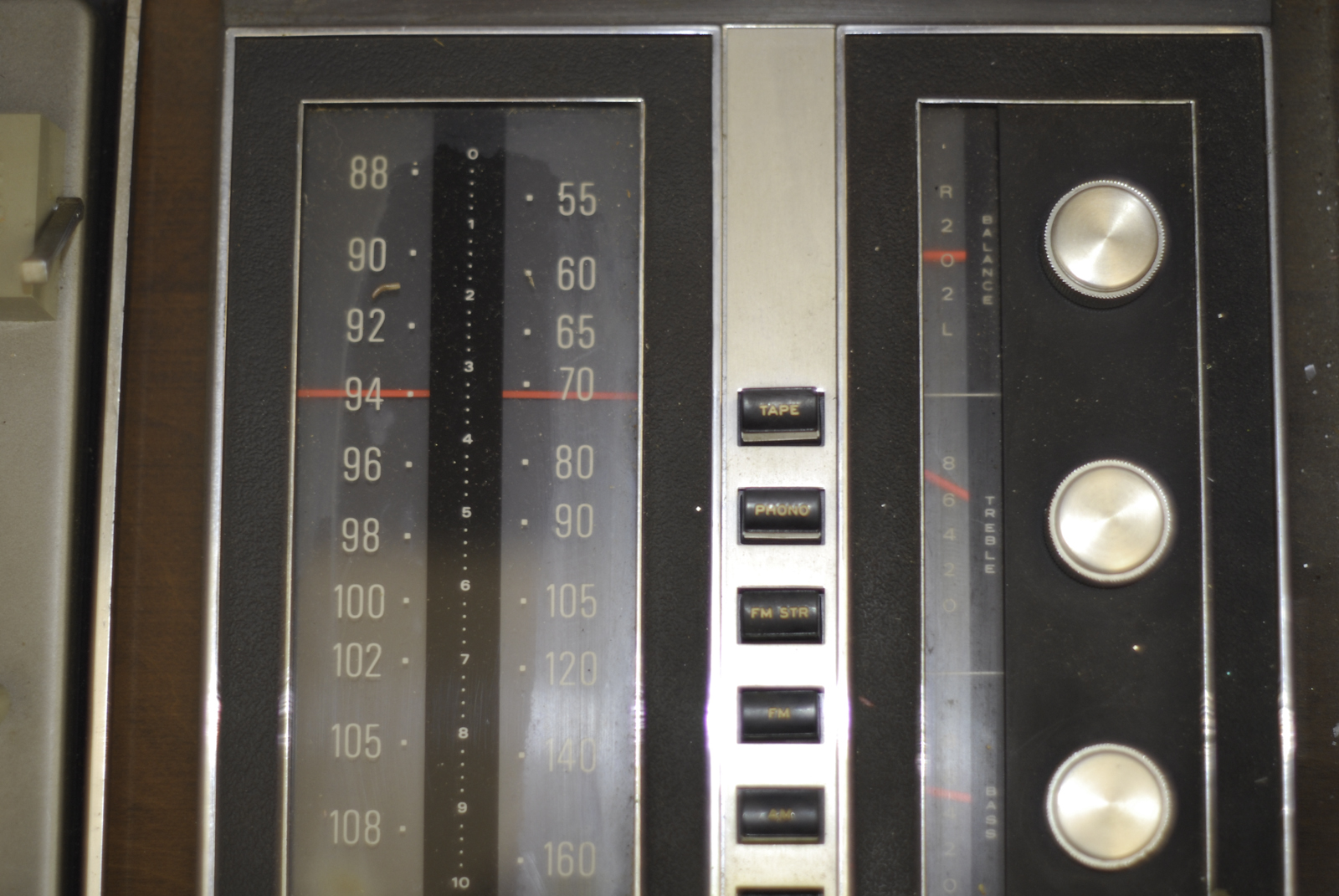

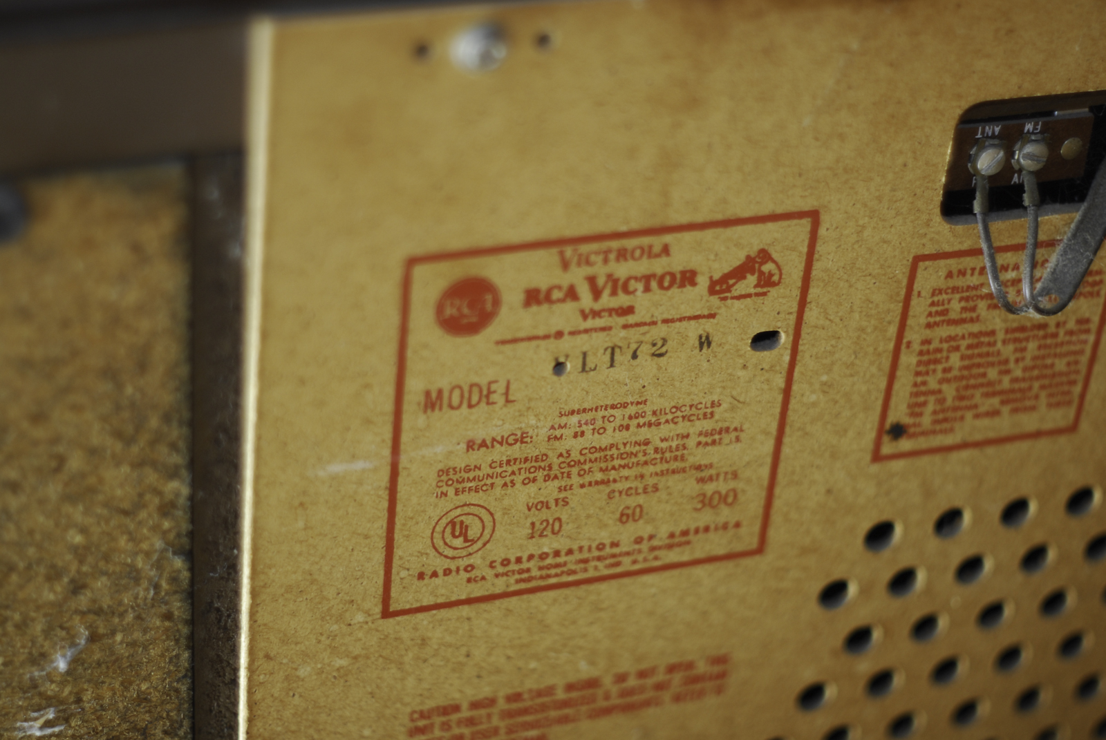

Can anyone help ID this bad boy? According to the label, it's a VLT 72 W.
-Steve

Mid-late 60's model.
Be careful of that (floating) cartridge - it's a special version not made any more.

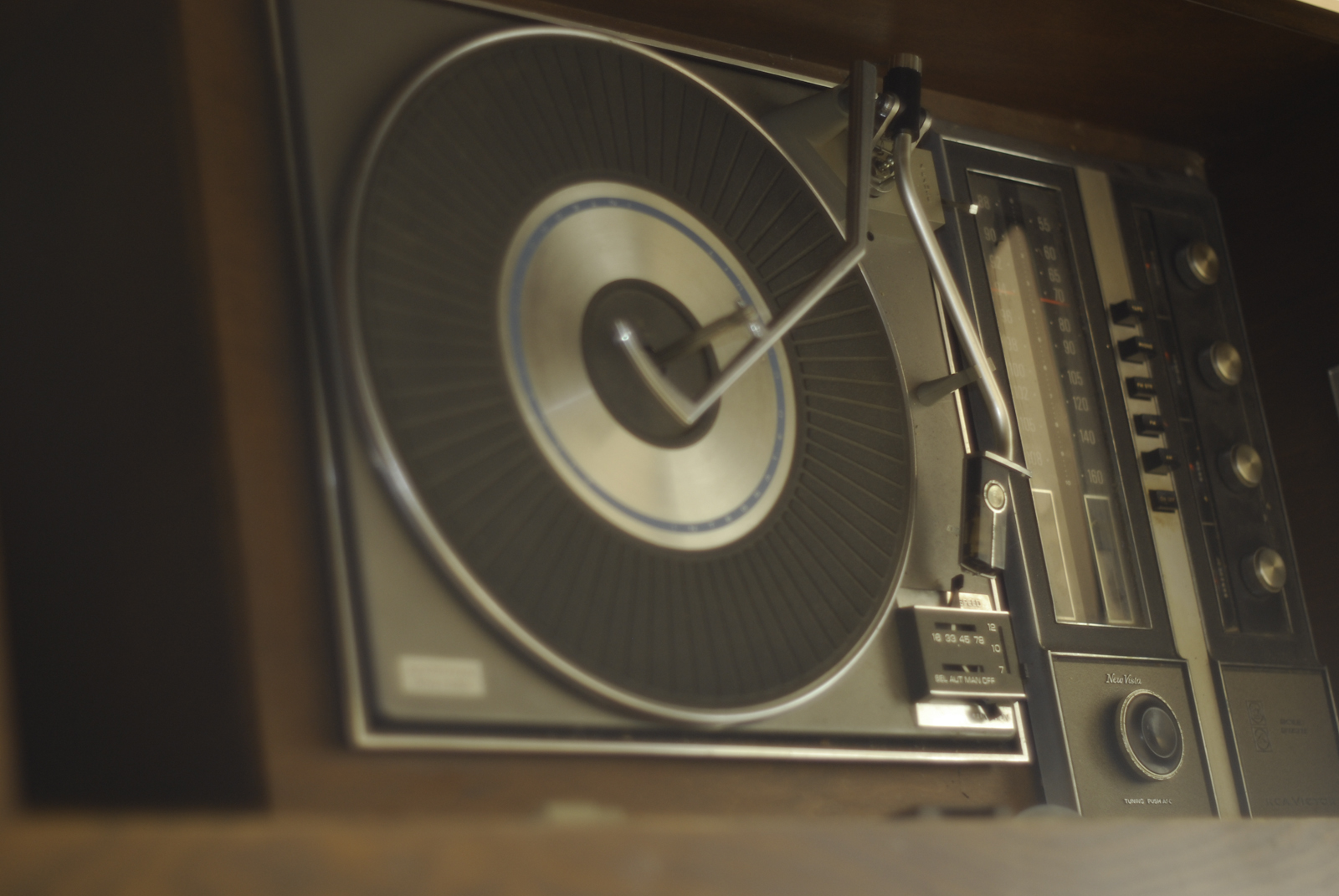

These changers do not use a belt drive.
They utilize an idler drive system.
Every one I've seviced by now needs a complete teardown, flushing, and relubrication, due to the 40+ year old lubricants drying out.
Have it done - I've got one in the shop that was never serviced, and now has a ruined motor, among other things, from lack of lubrication.
The synchronous motor they used in that model is near impossible to find, as well as that special electronic cartridge.

You have a 1968 top of the line model.
Follow Matt Tech's advice and have it serviced to enjoy another 40 years.

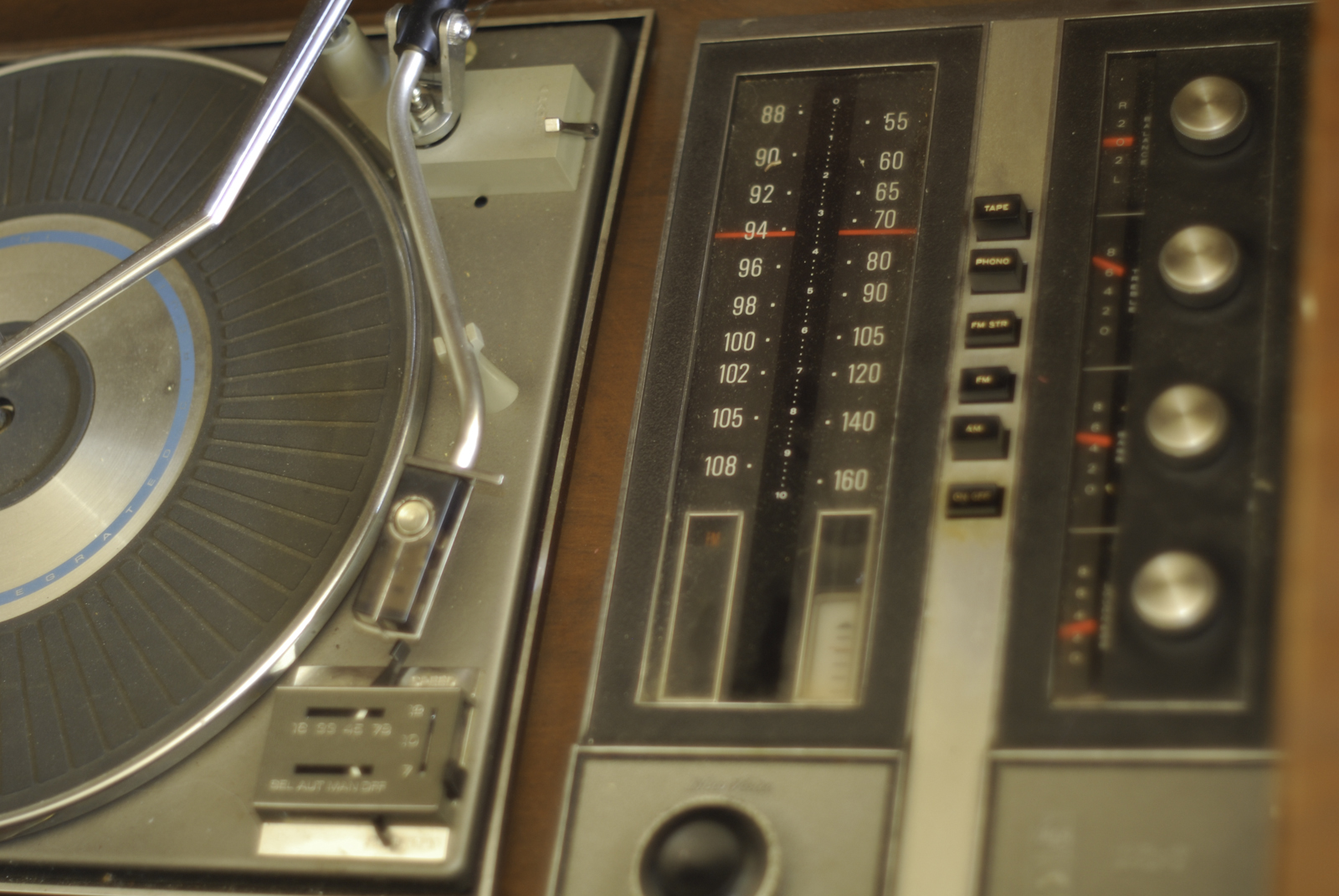

That special RCA floating cartridge has the preamp built into the cartridge itself, under the litlte silver button in the tonearm headshell

And this changer also is dual-wound to provide 22 volts AC to the preamp inside the cartridge.

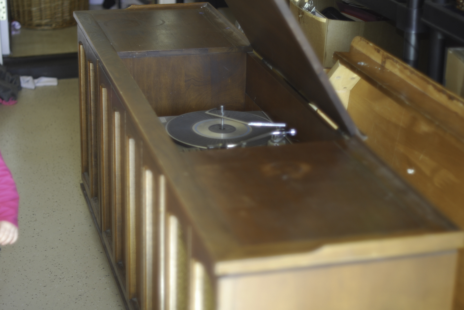

This is a console model. (see photos)
