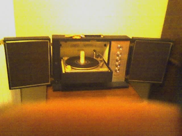

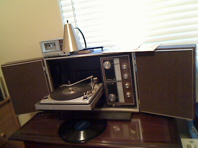

AudioTronics 300-E Classroom Recordplayer.jpg (29.76 KiB) Viewed 2115 times
AKAI X-1800SD plus 8-Track.jpg (3.93 KiB) Viewed 2115 times

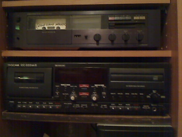

I have a TASCAM CC222 mkII dual deck machine. Ignore the cassette deck above it. It will dub from Cassette to CD or vise versa with adjustable level for a hotter signal transfer, and the cassette portion also has a pitch control. Plus, it will record directly to either portion from ANY external source, plus dedicated inputs to record directly from a turntable to the cassette or cd.
They will also play independently if you have two external amps and sets of speakers. Kinda interesting, routing the tape deck to one amp and speakers in one room, while routing the cd part to another amp and speakers in a second room. I got it from the Musician's Friend catalog for about $800.00 a few years back. --BB
