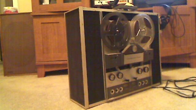

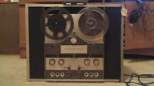

Sorry for not being of much help, not being familiar with the "magic mind" changers. The only Webcor I have is a Webcor/Coronet Tube reel-to-reel. Got it at the thrift store for $3.98 and only replaced a couple of belts and other minor tinkering, but it plays well. Haven't bothered to do the usual cap job, etc. on it, but that's on the to-do list.
It's got two 4x10 woofers that face forward at an angle and projects the sound from the front and sides and has two front-facing 3" tweeters.
