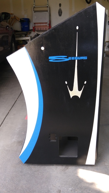

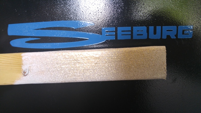

Its hard to see but I painted a test stick and sprayed it with the Gold Fleck this is what I was planning on doing with the crown rather than have it pin-stripped to complement the inside that I painted gold. Again it's tough to judge this by the example but what do you think?

I can't see the gold flakes from here--but either way it still looks great !

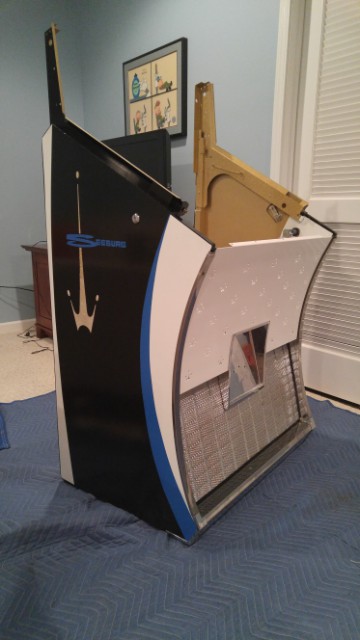

by burnt_finger » Sun May 29, 2016 6:22 pm

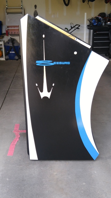

Well I am done painting, I plan on putting some polyurethane over the outside of the cabinet when everything is completely dry but otherwise I am happy with the way it turned out, the crowns have some gold flake in them witch is hard to see in the pictures but I didn't want it to stick out either.

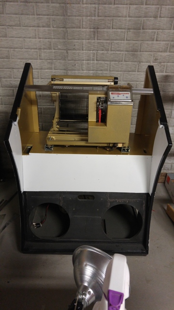

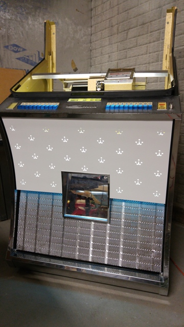

I was curious to see what my choice for the gold interior looked like, so I did a test fit.. 8)
Brad
Re: My DS100 restoration thread.
by Ron Rich » Tue May 31, 2016 7:10 pm
Hi Brad,
What waz the original color--blue, I think ?? Looks fine, except that it appears the tie down nuts may be tightened down--Those 4, 9/16 nuts should be run ALL the way up--till they jam, against the top of the studs-- Ron Rich

Hi Ron
The original color of the inside of the cabinet is the dark-grey / black color they used, same as the outside of the cabinet the rest is the same as original with the gold and white. I will have to check those bolt’s I almost positive I have those down all the way.
Brad
by Ron Rich » Wed Jun 01, 2016 3:34 pm
Hi Brad,
Being somewhat color blind, I seldom pay much attention to colors--yes--check them thar nutz---they iz NEVER supposed to be ALL the way down, as it compresses, and ruins the springs !! ( besides the mech will slide much easier if they are up)

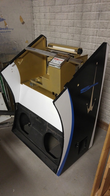

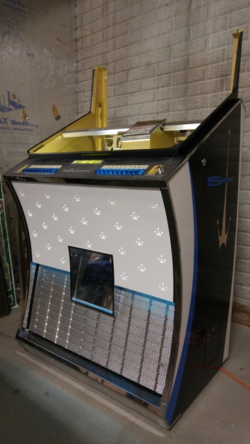

by burnt_finger » Thu Jun 09, 2016 2:35 pm
Starting to put it together, I still have the TES, back panels and door to redo but everything else is done and getting put back on.

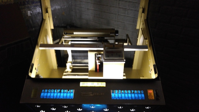

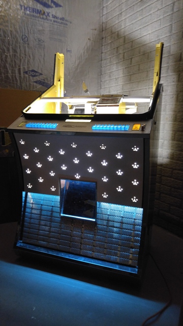

by burnt_finger » Tue Jun 14, 2016 2:30 am
TES is done and in, have the mech in and hooked up and selecting I started on the amp tonight so it might be playing by the weekend.
by Rob-NYC » Tue Jun 14, 2016 9:57 am
Brad, not withstanding a few very minor dings on the grill, that machine looks like it came off the assembly line.
Really remarkable and nice to see those often overlooked later Seeburgs get a first-class restoration.
