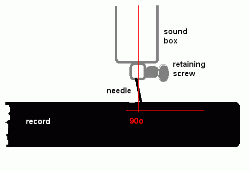

The main concern I have now is that, when I see the needle from the face,
it is not straight 90 degrees in the groove, because is clamped sideways by that tiny retaining screw.
This can't be good as it pushes more against the right wall of the record groove.
Have i put it wrong or it is designed to tilt so????

When the needle is seen from the angle in your illustration, it should be straight up and down, as indicated in this illustration:
(FROM -- http://www.nipperhead.com/old/vic4sb01.htm )
Check to make sure that there isn't some debris or something that prevents the needle from lying flat against the area opposite the thumbscrew.
The sound box, itself, should be situated so that needles is angled about 55 degrees to the surface of the record -- similar to the sound box illustrated on this page -- http://www.nipperhead.com/old/vicsprng06.htm
There was a recent post about an HMV 101 that you may want to look over, since it contains information about restoration tips, etc. -- viewtopic.php?f=7&t=2505&start=0

Unscrew the needle screw a little farther than you have, and then push the needle in farther.

You might find that the problem is also with the needle itself. I have discovered the same problem with certain SOFT TONE needles (the thinnest type) when the thumb screw has been tightened up, the needle leans inwards. Thicker needles do not seem to have this problem in the HMV soundboxes but you will get an increase in volume. I found the worst culprit was the HMV 5a soundbox with some very fine soft tone needles I've got. The needle leans exactly the same as your diagram.
