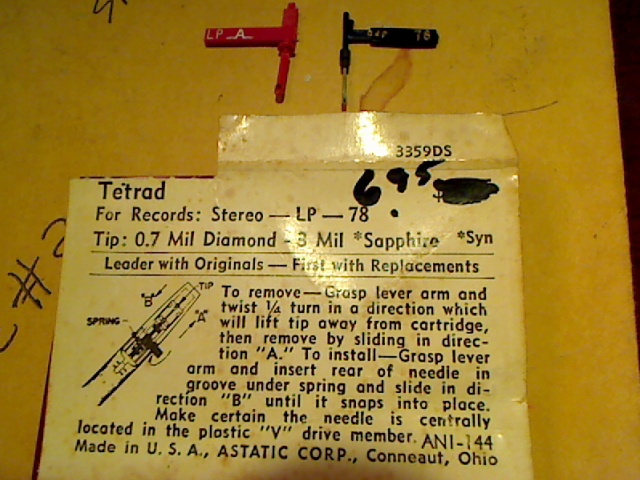

Dual needles could be be labeled LP/S (sapphire or stereo?) on one side and 78 on the other, or one could be diamond and the other sapphire with no 78 designation. Get the number off the back of the cartridge to narrow your search.
This Electro-Voice 275 is basically the same as an Astatic 165d and has a Magnavox number 560345. I don't know about the 802 number, but starting with the Magnavox number will back track to an EV or Astatic match. That match will also lead you to the correct needle.
Picture 8.jpg (95.99 KiB) Viewed 3626 times

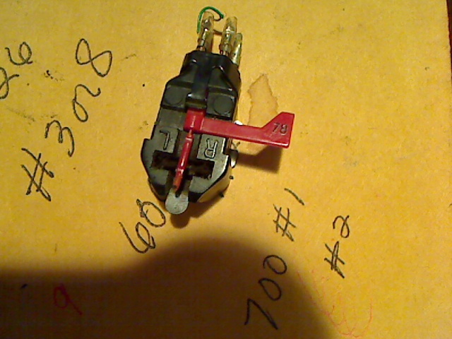

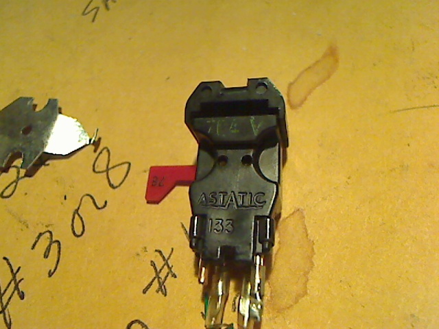

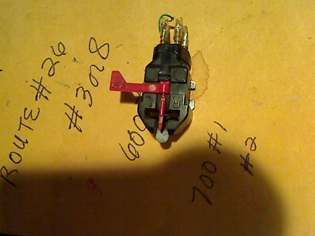

Here's another back of a cartidge that came from a VM changer:
Picture 32.jpg (95.88 KiB) Viewed 3626 times
Picture 29.jpg (125.13 KiB) Viewed 3626 times
Picture 30.jpg (98.06 KiB) Viewed 3626 times
Picture 31.jpg (95.22 KiB) Viewed 3626 times
Everything in a console is not made by the same company. It's like having a car of your choice with a sound system made by Bose, speakers from Jensen, tires by Pirelli etc...parts and accessories from manufacturers everywhere coming together to create a final product. --BB
