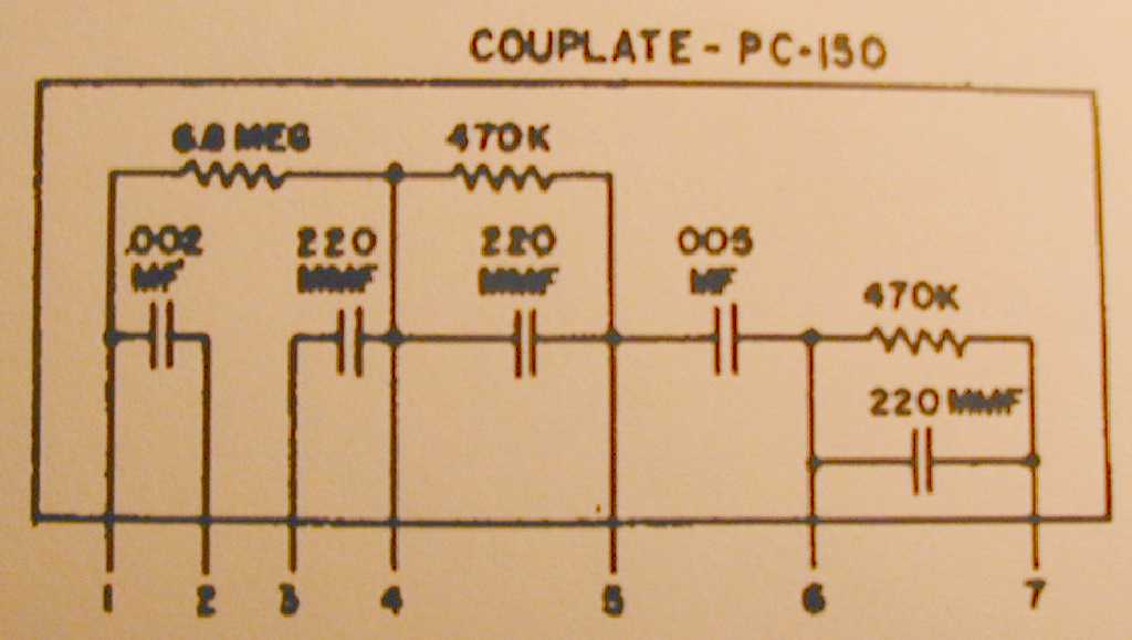

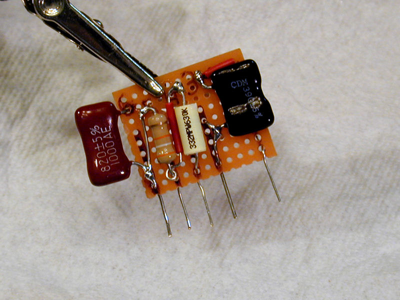

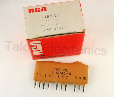

Yeh the old Rockola amplifiers used what is called "Couplates" connected to the volume control and other parts of the circuit. Couplates are a special component which has several resistors and capacitors inside it and it's sealed so there is no way to repair it.
Here are pictures of a couplate, a schematic of a couplate, and a picture of a home made replacement couplate.
Couplate homemade guts.jpg (103.19 KiB) Viewed 363 times
Couplate schematic.jpg (34.36 KiB) Viewed 363 times
Couplate picture.jpg (46.54 KiB) Viewed 363 times
