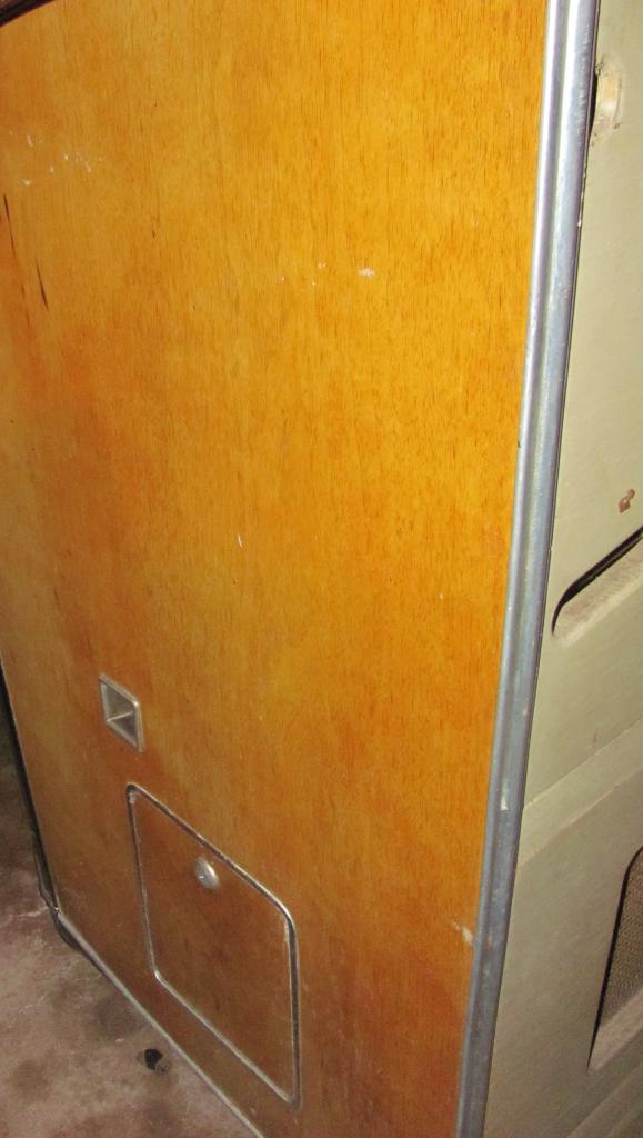

My Wurlitzer 1900 has the most beautiful condition original sides anyone could ever ask for. No gouges, scratches or nicks. I know in 1956, wurlitzer painted (I think it was called dynaweld) over walnut wood veneers. I don't want to ruin the original finish, but I was wondering if anyone has had success cleaning these types of stains off the painted wood surface. Talking to a jukebox restorer, he advised me to never try cleaning the nicotine with any cleaners. He said to put up with it and it is what it is. In his years, he's tried a lot of things, but he said that it will have "zebra stripes" in the finish and that I'll do more harm than good. Anyone want to share their experiences? Have before and after photos? I can tolerate it I guess, I'm just trying to do my best to snaz things up I guess. :)

I recently started work on this wurlitzer 1900 and aside from a few nicks here and there, the sides are in really nice shape. Just "smokey" or "tar coated" if you want to call it that. I'm not sure if I should try risking cleaning it, or just put up with it. I'm afraid if I clean it with something, it'll look "blotchy".
Am I right in my logic thinking that the walnut veneer on the cabinet will have areas where the wood is of different density? If that's the case, will it not clean evenly? I've had good luck cleaning tar stains from everything metal or plastic. I've just never tried on the outside of a cabinet, and I'm just not sure what to do.

Keep in mind, that Wurlitzer I think used a DI-NOC finish first developed by 3M. I'm not sure what this finish can accept or resist. Perhaps I should start with a small thing, like the coin door. At least, if that screws up, I will have less work into fixing it than a whole side. I'm still hesitant to try, as I know once I get started, there's no going back. :shock:
